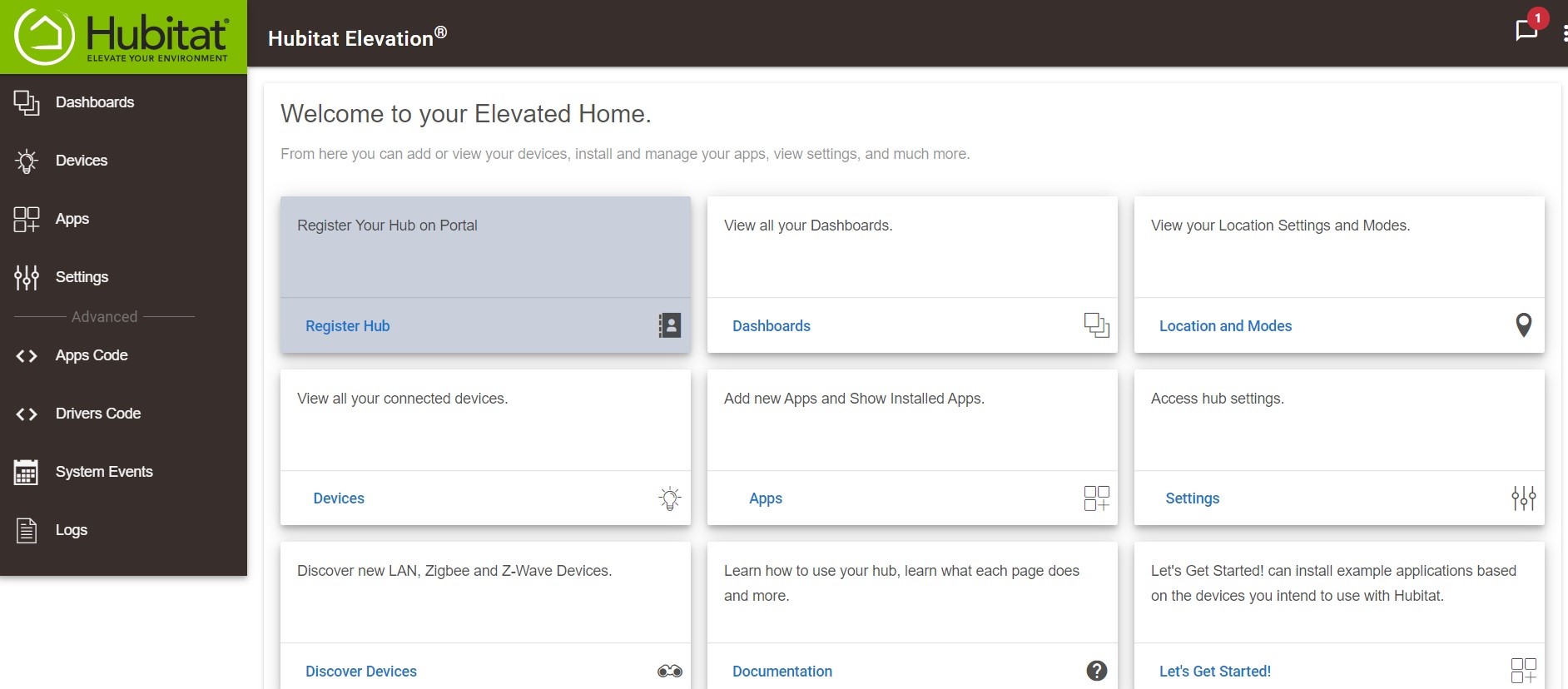

After clearing out the certs during troubleshooting and trying to re-register, I go to this screen.
Click on the register your hub
and it thinks about it a little bit and takes me back to the Settings main page.
So, ultimately, I don't know for sure if I'm registered or not.
