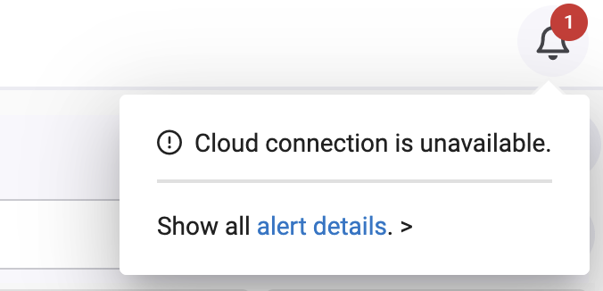

This morning I discovered that I can no longer connect to the cloud portion of Hubitat. My local dashboards and local access are working fine, but all cloud dashboards and cloud connectivity appear to be down.

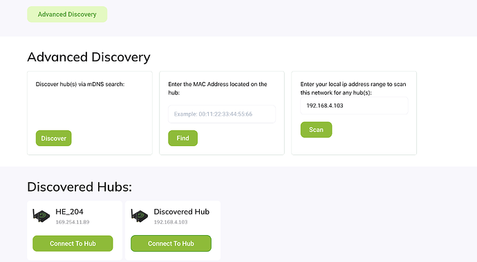

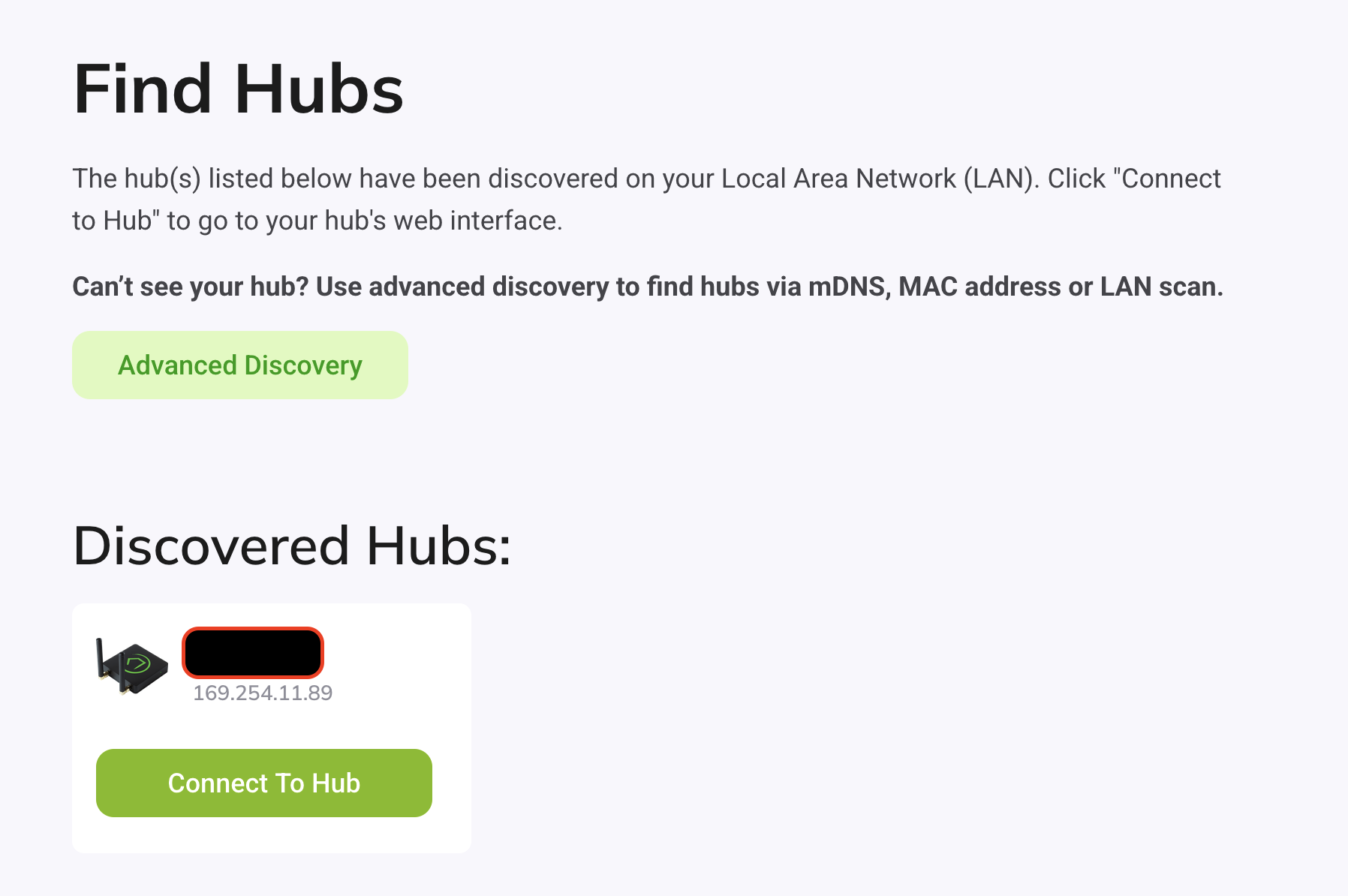

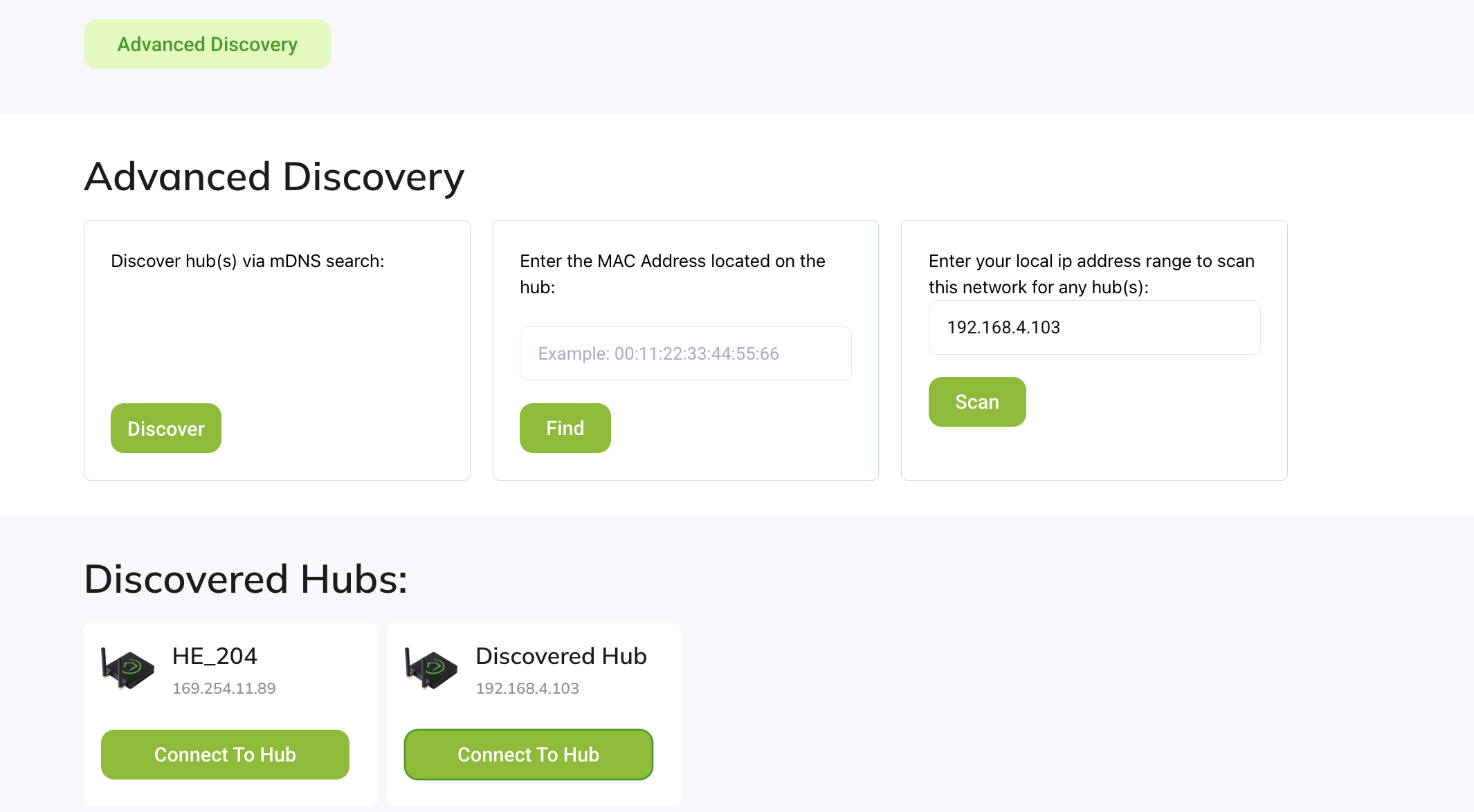

One additional observation: when I perform a network discovery, Hubitat reports a 169.x.x.x address. However, I am still able to access and configure the hub locally using its assigned IP address of 192.168.4.103.
Has anyone experienced something similar after an Eero update, or is there anything else I should check?
This address simply means it assigned itself an IP address because it was unable to request and receive an IP address from the DHCP server (your router).

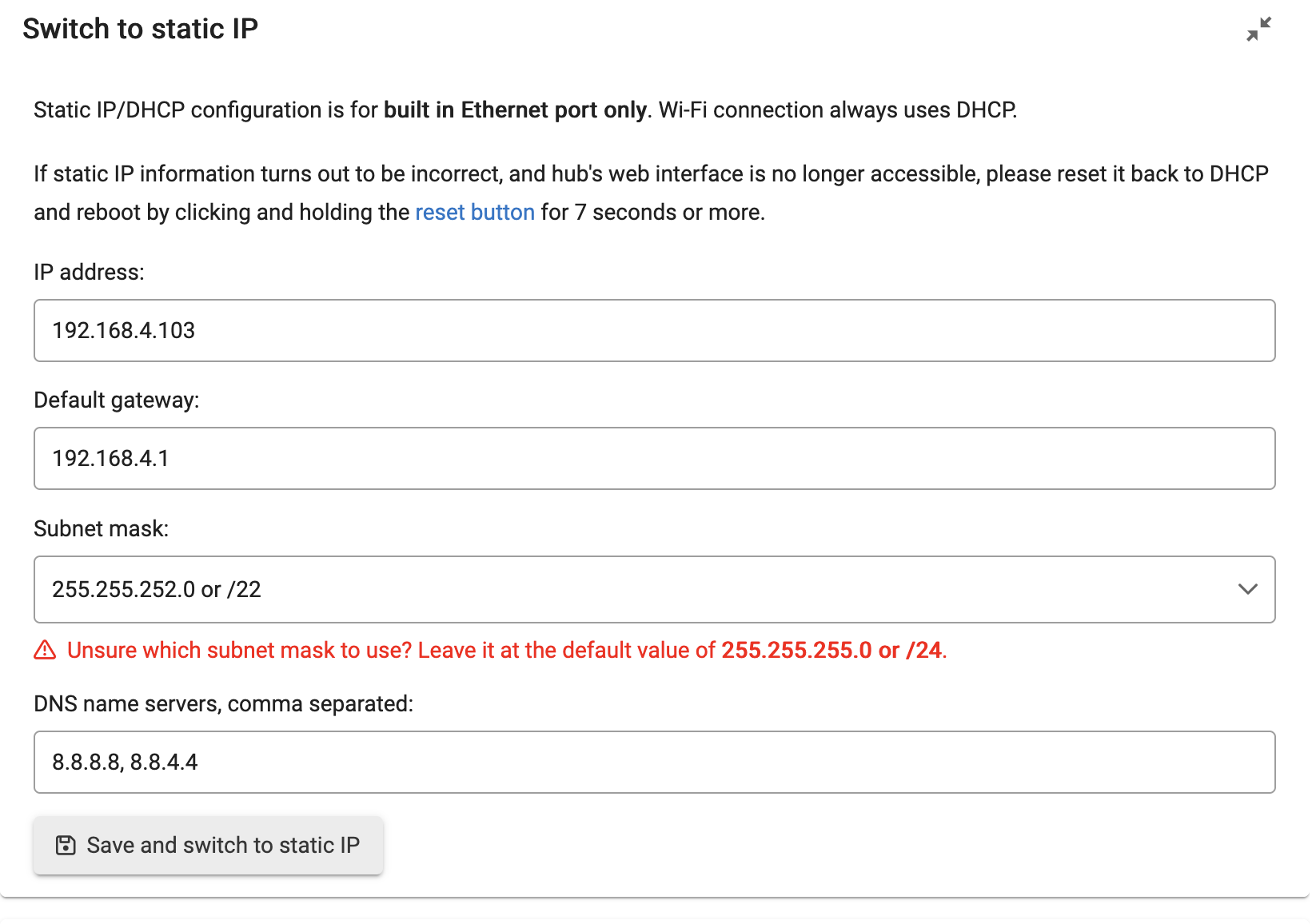

Are you using both a DHCP reservation (set in Eero) and a Static IP (set in HE)?
IIRC, doing both can be problematic (not an issue unique to Eero)…. I’ve only ever used DHCP reservations for all my stuff on Eero – I’ve never messed with Static IPs for anything.
I’ve done every test possible, but thanks for responding and all my other devices came back online as well after the update. This has been my setup for 7 years.
Only DHCP reservations is on all my stuff on Eero, not on the device, but I did troubleshoot by DHCP on Eero and Static on the Hubitat device same results.
What concerns me is that screenshot you have for “Switch to Static IP”. I’ve never seen it. The whole point of DHCP is to have the host do the client configuration. I’d think any attempt to designate an IP address, gateway, DNS server, etc. on the client itself is only asking for trouble.

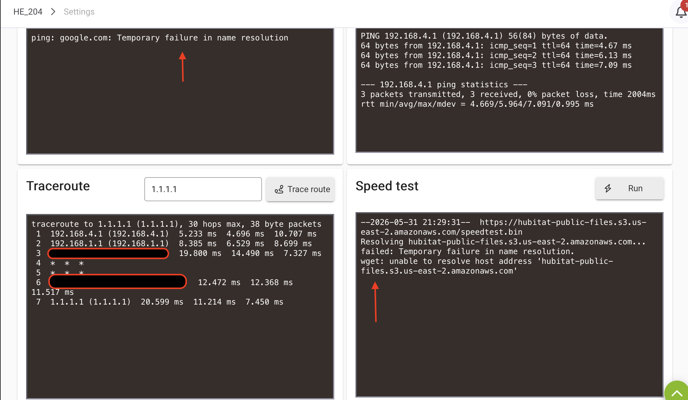

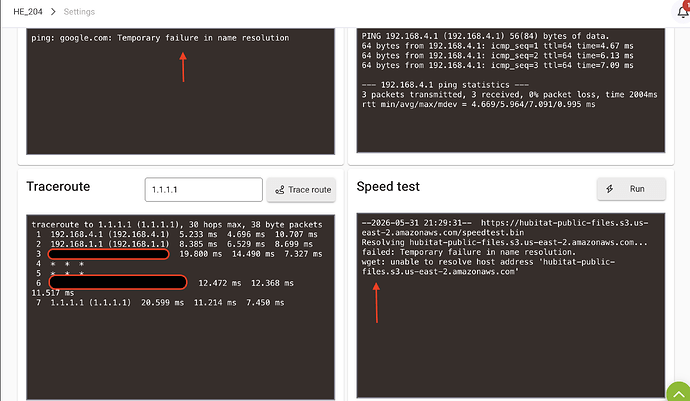

Your ping test to google.com is saying your DNS server is not providing the IP for google.com.
That could be because your DNS server is not providing the information, or the Internet is not accessible, and a DNS server cannot be reached.
You need to determine if you only have a DNS problem, or if you truly have no access to the Internet.
First test if you have access to the Internet by pinging 8.8.8.8. If that works then you have confirmed Internet access is available, and your problem is with the DNS server
Normally another way of confirming Internet access is to go to https://my.hubitat.com. After logging in, click on Registered Hubs, and then Hub Details. Scroll down to "Last Check in" to see if recent communication has taken place. However if your DNS server is not working, as I expect, then "Last Checkin" will be quite old.
Your traceroute test also shows you have a double NAT situation. Depending on how you use your network, that is normally something you don't want. You have probably had this all along, and therefore I don't believe that is causing this problem.

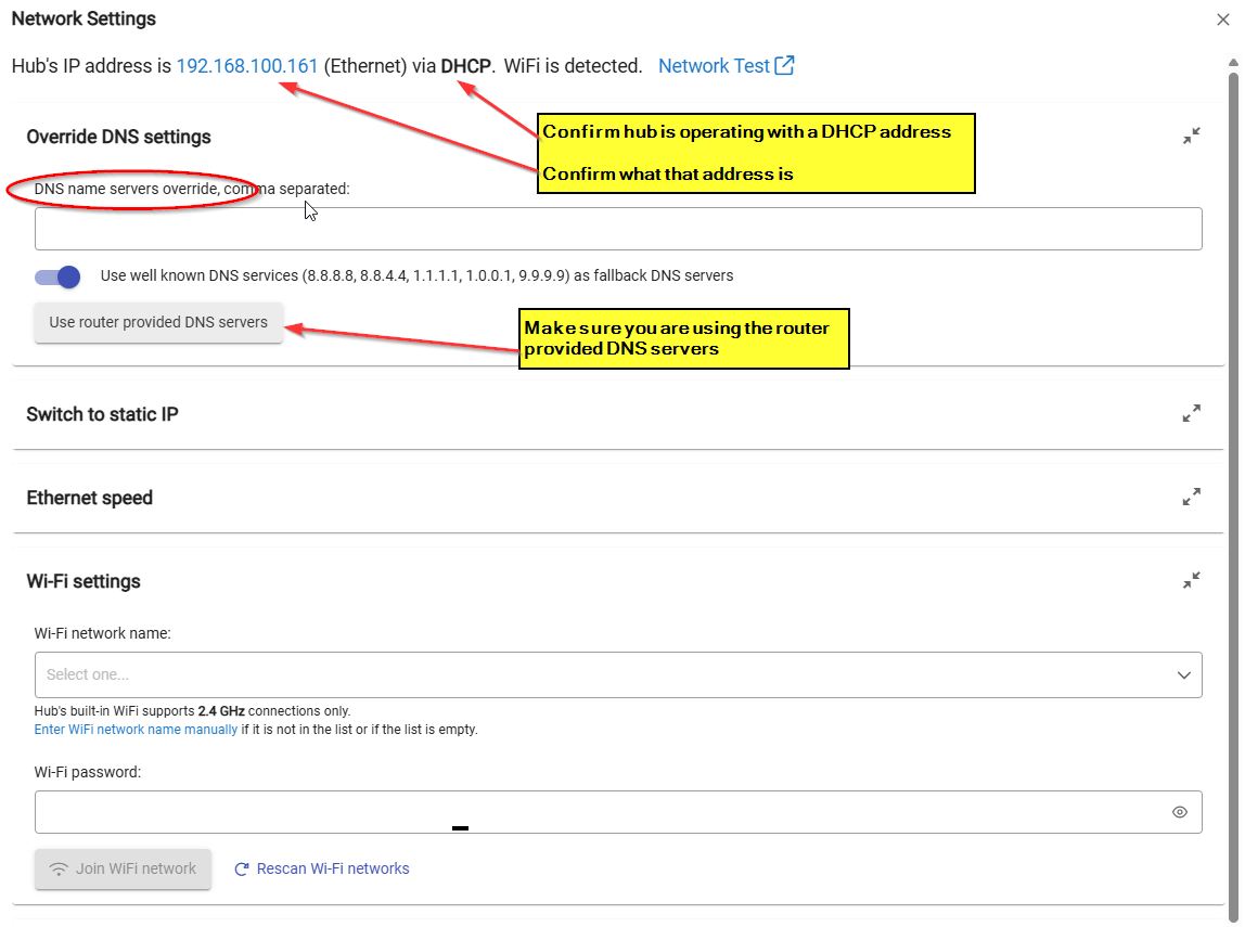

I have re-read your original post, and I don't see any mention if you are using an Ethernet or a Wi-Fi connection. When @HAL9000 suggested switching to Wi-Fi you still didn't say what you were using.
Either way, open network settings and confirm hubs IP address, and if the address has been obtained by DHCP (if you are using an ethernet connection)
Also open the "Override DNS Settings" section and make sure you are using the router provided DNS servers.

Also this is new this morning, I now see two devices on my LAN, how there’s no other devices…
The extra hub is because of the self-assigned IP address. Once the hub is able to pick up its proper IP address from the router, that one should go away.

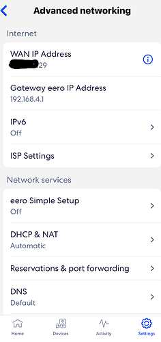

Here’s my Advanced Networking on the eero if you want to compare. The eero gets its gateway address on the ISP side from the ISP. It presents a non-routable local IP address for the gateway to the local network side.

As I said earlier, the error regarding DNS may be because of a bad DNS configuration or DNS server, or your hub may not have Internet access at all, preventing a connection to a DNS server.
Please try pinging an IP such as 8.8.8.8 rather than google.com like you did before.
Your traceroute test seems to show that you do have access to your ISP router and the Internet.

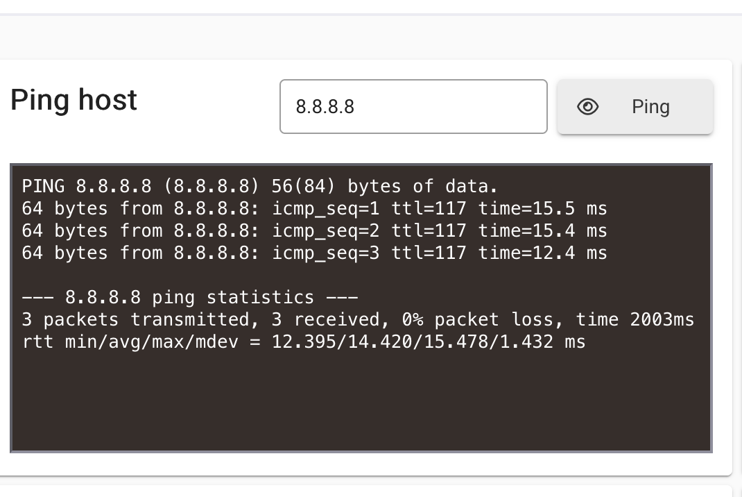

I can ping 8.8.8.8
That proves that all aspects of networking are correct except DNS. If you had previously overrode the DNS server settings with 8.8.8.8, then the problem would definitely be the hub, because now we know the DNS server is available.

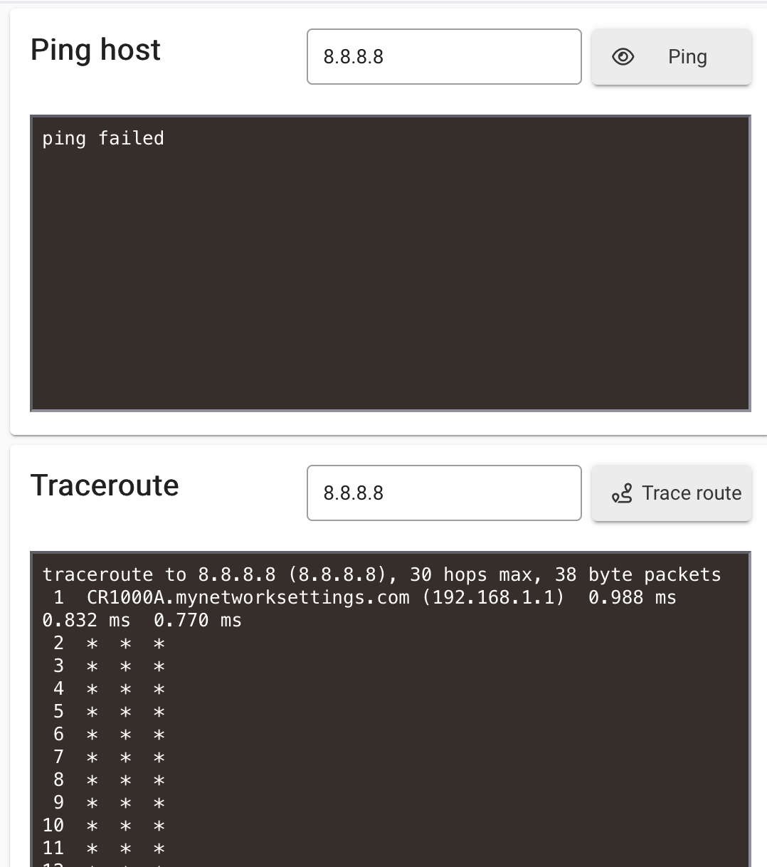

Same issue when plugged directly into the Verizon Router. New IP was assigned as well 192.168.1.175. Network reset as well.
Did you do a network reset on your hubitat after plugging it directly into the Verizon router? The double NAT you described earlier will require that.
Yes everything was reset after the connection to the Verizon Router, I even Factory reset the Verizon Router as well.
That's not the same issue. Previously you were able to connect to 8.8.8.8, and now you can't.
Is the ping gateway test now failing as well?
At the very least the problem doesn't seem to be related to the Eero update.
