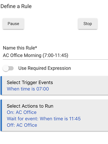

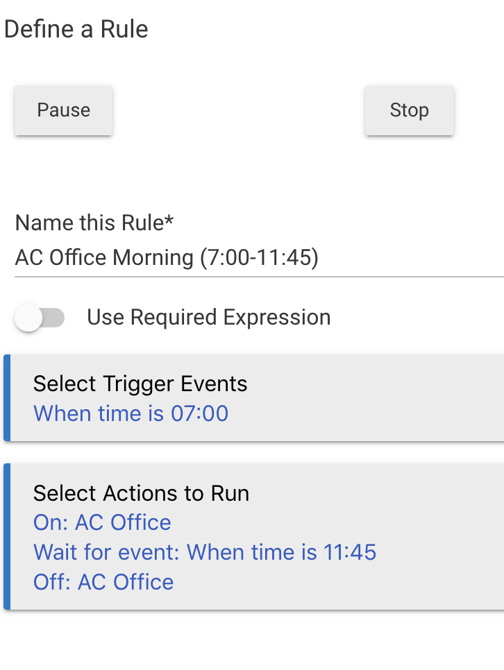

Can you post a screen shot of your original rule?
But it doesn't matter which rule it is....
Oh OK. I was wondering if maybe you had a broken or corrupt rule and that was the issue. If it's literally every rule I'd say you have a bigger problem.
