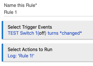

I don't believe cloned rules are paused by default, or at least I don't remember reading anything about that in the past and can't find anything with a search. It's also easy to test, so here's a simple rule I wrote:
Rule screenshot: trigger on switch change
Then I cloned it and (without opening the rule at all) triggered what should be both automations by changing the switch state. As expected, both triggered:
