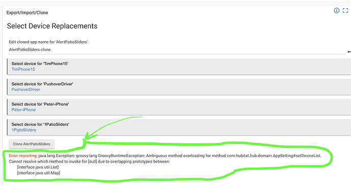

Hi Hubitat Community, when I attempt to clone any existing Rule Machine app rule, I get the message shown below. I did a reboot I have no idea where to begin troubleshooting this condition; any thoughts? I am on C-8 device running version 2.4.4.146 I just updated yesterday. Thank you!
I believe this is a known bug in 2.4.4.146. For now, either wait for a bugfix, create the rule anew, or load an earlier platform version and clone the rule.
Thank you Ashok, I know I had used it in an earlier version. I appreciate the reply. Will clone manually for now.
I get that error on 145 also.
