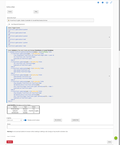

I attached a screenshot of one of the rules that has the Hub Variable "frontPorchLightAutomationRunning."
Just an FYI... I am using this variable to disable the button controls rule when I have a holiday light rule/animation is running.

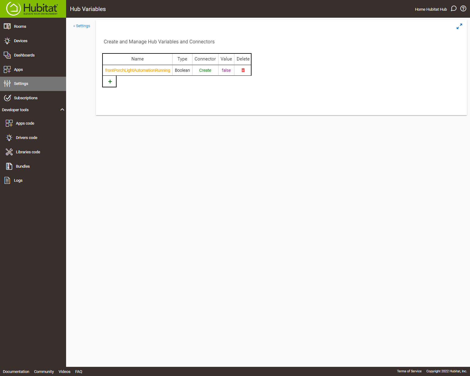

Show a screenshot of Hub Variables in Settings.
Sure...
So the yellow text is a link. What happens when you click on it? Also, what happens when you just hover your mouse over it?
The fact that it's yellow means there are apps using that variable.

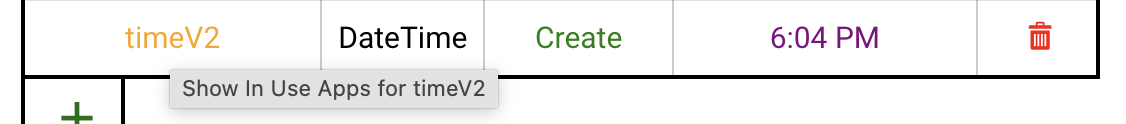

Here's what I get with mouse hover:

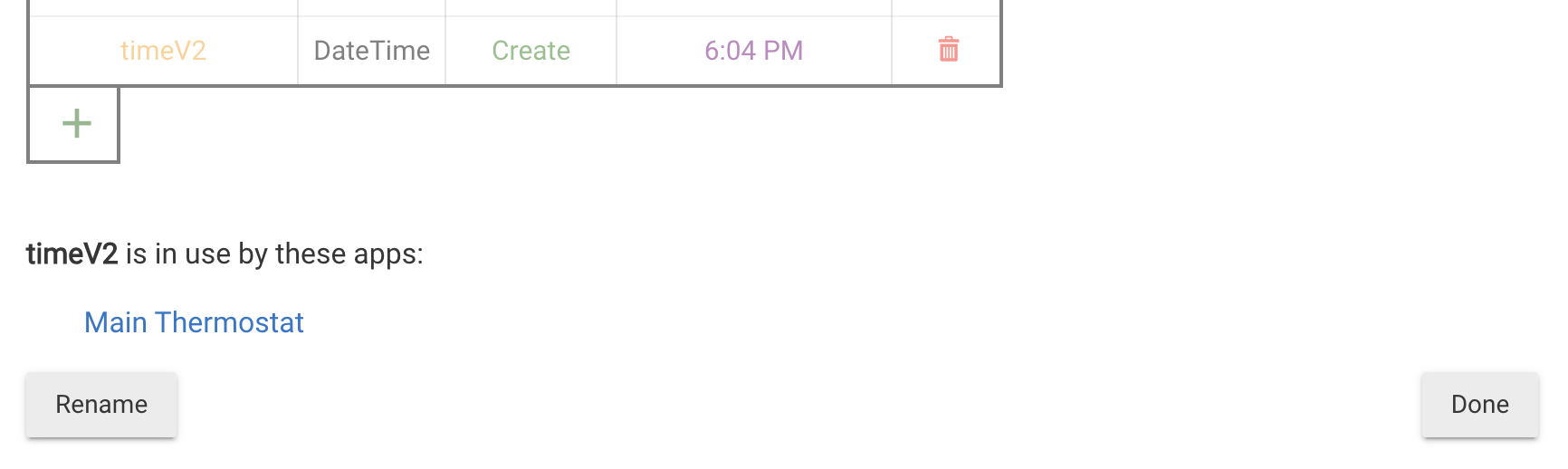

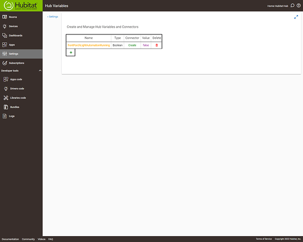

Then, if I click on the yellow text, I get this:
Yeah the hover is working but when I clicked on the Hub Variable, it wasn't displaying which rules are using it.
