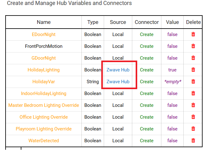

Minor bug, if going to Settings -> Hub Variables
When I have a variable shared using Hub Mesh, on the Hub Variables page I click on the link to the other Hub:
It redirects to URL:
http://10.111.11.3/login?loginRedirect=%2Finstalledapp%2Fdirect%2FhubVariables
10.111.11.3 is the IP Address of my Zwave Hub. The problem is I can not log into that hub at all using this URL. I'm able to reproduce this issue every time as well, I have to remove the end of the URL: "login?loginRedirect=%2Finstalledapp%2Fdirect%2FhubVariables" then I can log in. Even if I'm already logged into this hub in another browser tab, it'll prompt for the log in and not work. I have both hubs setup with security that requires you to log in.
