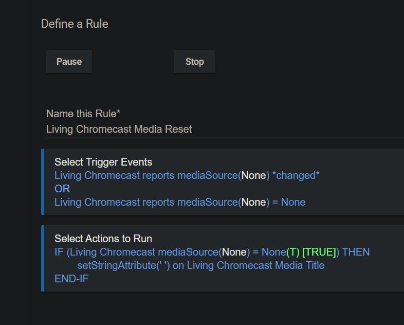

I noticed something earlier tonight with a rule I was working with and thought may be worth mentioning... It's not stopping me achieving what I want, so no urgency to get a fix...
When I setup a rule triggered by a change in the custom attribute mediaSource on a chromecast device, the rule does not fire when the mediaSource attribute changes back to 'None', the rule only fires when the mediaSource goes from 'None' to something else.

Hmmm, maybe I need to re-create it then. I set it up probably 2-3 weeks ago, so was probably on an earlier version, but am up-to-date now in terms of HE firmware. I added some extra logic earlier this evening to handle it (the additional trigger on mediaSource=None):
Looks like re-creating the rule resolved it.... strange... Thanks for prompting me to look at it again @Sebastien
