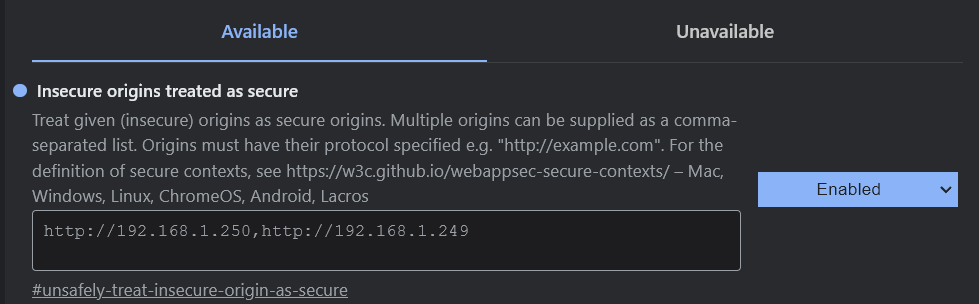

Go here:
chrome://flags
Enable IP's here:
Thanks @UserSeventeen and @dnickel !
