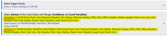

I am running a rule that initializes and refreshes every 3 hours on my out of box chromecast integration beta. NOT fully broken on .132. I have always run this because all my TTS devices have had issues staying connected.
Highlighted are chromecast, not highlighted are Samsung speakers
