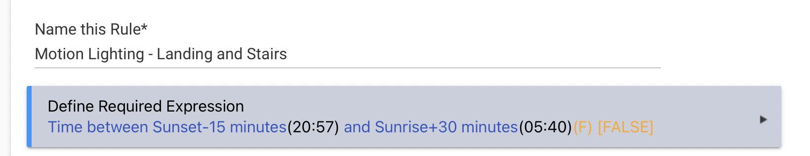

3 - This one I'm not sure of - expected behaviour or bug? Two separate RM rule for some lights have a required expression of between 2 times:
The first (Hall and Stairs) is correctly showing 'required expression false'. This is only because at the point I took the pic, I'd already opened the rule and clicked Done which fixed it. The second (Landing and Stairs) is not showing 'required expression false' in the RM child list, but is when I open the rule as below....
....it is showing false. At that point the RM rule was ignoring that required expression and bringing the lights on. Clicking Done fixed it.
So at the time the Hub rebooted when the database was restored, should it not have booted with those time related required expressions false?

This might also be similar to the above--was the hub off when this time change happened? The required expression creates a scheduled event for the beginning or end time, and the same as other scheduled jobs from above applies here. This isn't constantly checked, presumably because it would be a waste of resources to do so constantly when the hub is functioning normally.
Hitting "Done" re-initializes the rule, including re-evaluating the required expression, so that is probably the explanation for the difference between the two.

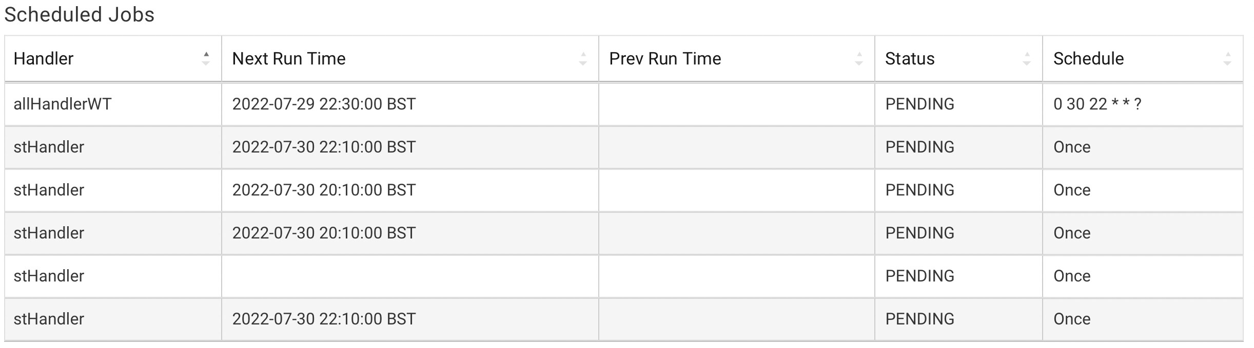

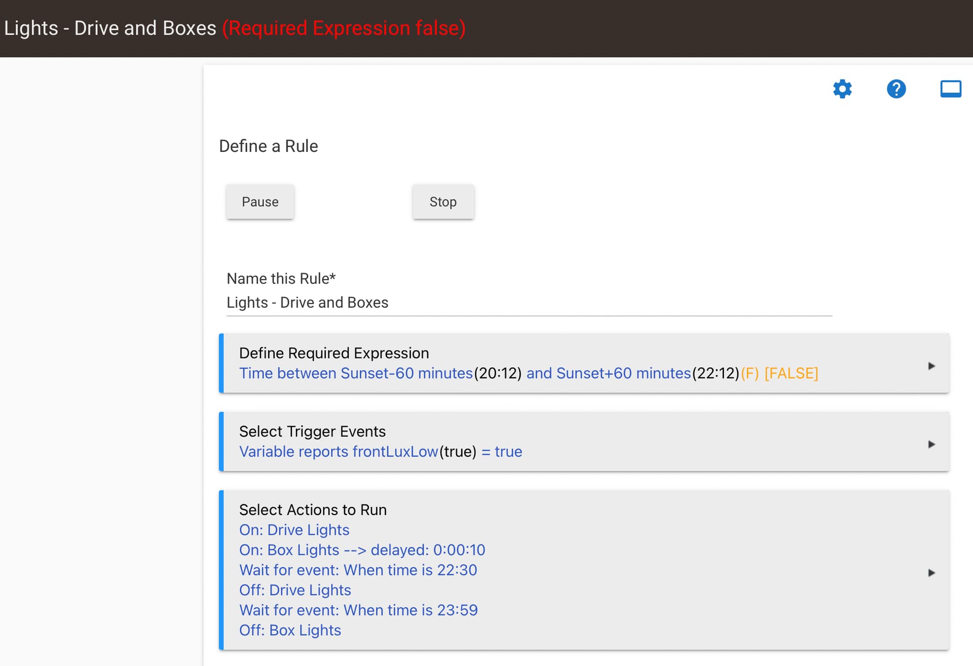

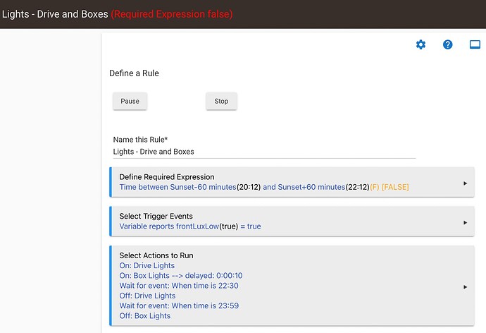

I've another rule I forgot about that is in a similar incorrect state currently. I've left it untouched for now. So the power cut and restore happened while the required expression was false and it should have switched to true at 20:12 but has remained false. I guess that following the restore, the required expression wasn't scheduled. It's now 22:28 here in the UK:
There are pending scheduled jobs for the off events, but the expression is showing false and the lights never came on:
I understand the reasons for the other issues I had following the restore, but expected that as all of that happened before the required expression time, that those rules would be unaffected.
