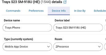

I don't have an answer as to how to do that... But, I would like to know why you wouldn't just reuse the old phone devices on the Hubitat Hub? This makes everything so much simpler when changing to new phones, as none of the Hubitat Apps on your hub need to be touched to swap the new phone devices in for the old ones. Everything will just work like it is supposed to. That is the whole purpose of the Hubitat Mobile App asking the question to reuse a phone device that already exists on the hub. If the name of the phone device is what you want to change, simply open the device details page for that device on your hub and change the LABEL field to whatever you'd like. I personally like naming those devices something like "Dan Phone", so that it is obvious whose phone it is. YMMV, of course!
You can also change the device name. I set the name as {person's name} Phone and the Label to the {Person's Name} + {Device Model}. As long as you are not messing with the device ID, it doesn't mess anything up and maintains continuity in apps. Also makes it easier if you have to pick the device again due to a logout/log back in situation.

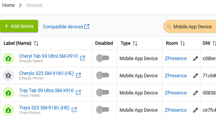

Assuming you have phone devices in hubitat that are currently tied to automations, I would first change the names and labels of the devices in hubitat (preferably on the web interface on a computer) to "his" and "hers" or the appropriate names.
Device Filter for Mobile App. For reference, the small text is the device NAME, the larger text is the device LABEL. I do not recall if the app presents the names or the labels. So, I would change both.
Then you may need to log out of the app on both devices. I would also force close the apps on your phones, and then clear cache and device data BEFORE you try relogging in the app. Since the names are changed, you can log in and should be able to pick the appropriate names when prompted to select devices. The easy way to find the devices is on the device tab and filter for "Mobile App Device"
