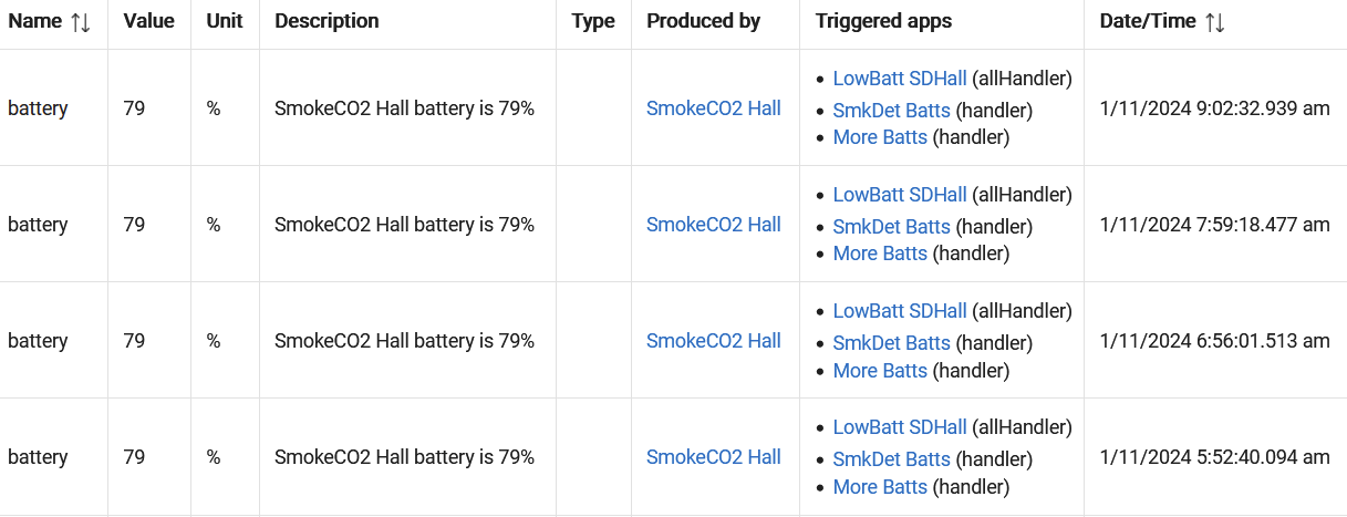

I have 3 First Alert Z-Wave Smoke and CO detectors, configured as "Generic Z-Wave Plus Smoke/CO Detector". I have Rm rules that monitor the battery levels, to alert me if they go low. I had the triggers as battery level changed, but that triggered on the of the rules every time the device sent a battery level event, even though the level stayed at 79%. The battery updates are received about every 63 mins. I changed it to Decreases and it stopped sending the redundant messages. However, I would prefer to go back to Changed, so it can update some info on battery replacement. Of course I could add that as a second rule, but I think there might be an issue here with how the Changed triggering works.

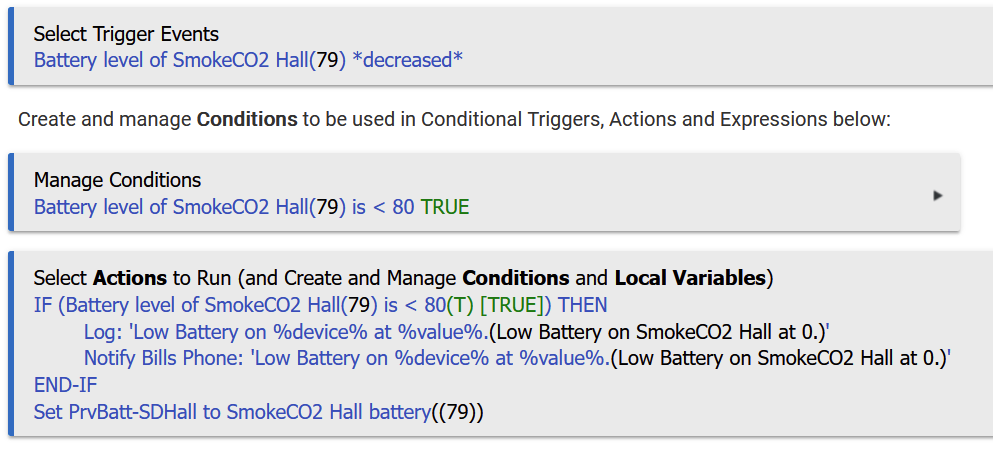

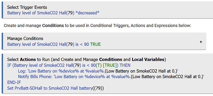

Here is the rule, with the Decreased trigger...
Along with the last few battery events for the device...
I am trying to figure out what your intent is with this rule. Why do you need a report when the battery is under 80%? What is the battery level where you need to change it?
What does the "Set PrvBatt-SDHall to SmokeCO2 Hall battery((79))" supposed to do?

That was old code I hadn't deleted, yet. Used it to limit msgs to certain incremental changes, until I figured out exactly the the device battery behaved.
