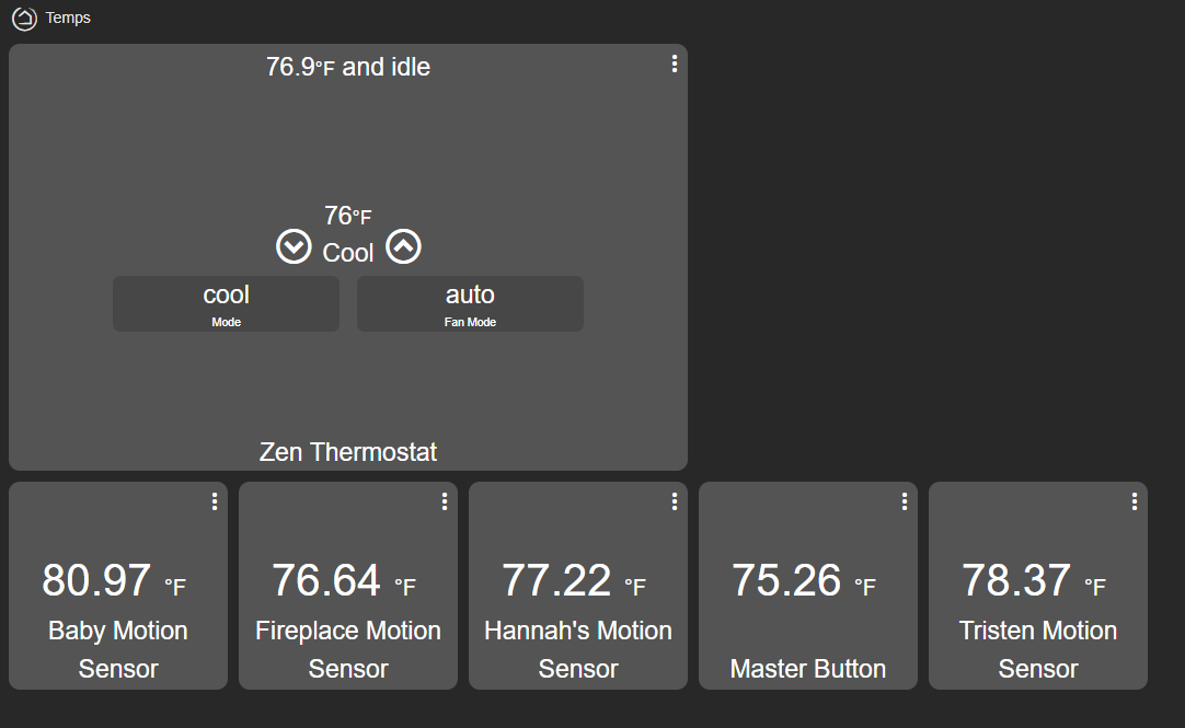

Ah OK thanks, so in the screenshot attached which tile would correspond to the large Zen Thermostat tile?
click on the 3 dots in the right corner and it should show you the tile name in the upper left of the dialog box that is shown.

I'm just trying to change the font for that tile alone without impacting the other tiles on the dashboard. Sharptools allows for this but I do not want to use a 3rd party dashboard app anymore.
A little more complicated but this should be close:
#tile-81 > div.flex.flex-col.w-full.text-center.h-full.justify-center.items-stretch > div.flex-grow-0.w-full.self-start.cooling > div
     {font-family:calbri}
#tile-81 > div.flex.flex-col.w-full.text-center.h-full.justify-center.items-stretch > div.flex.flex-grow.flex-no-wrap.flex-col.w-full.-mt-6.justify-center.overflow-auto > div.cooling.w-full > div
#tile-81 > div.flex.flex-col.w-full.text-center.h-full.justify-center.items-stretch > div.flex.flex-grow.flex-no-wrap.flex-col.w-full.-mt-6.justify-center.overflow-auto > div.w-full.my-1 > div:nth-child(1) > div
#tile-81 > div.flex.flex-col.w-full.text-center.h-full.justify-center.items-stretch > div.flex.flex-grow.flex-no-wrap.flex-col.w-full.-mt-6.justify-center.overflow-auto > div.w-full.my-1 > div:nth-child(3) > div
#tile-81 > div.absolute.bottom-0.text-center.w-full
