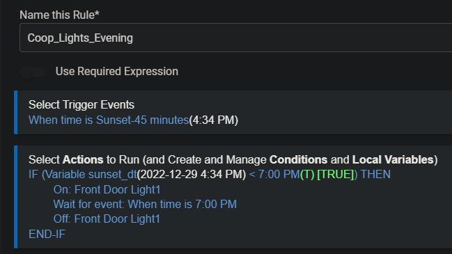

  1. Make two hub variables of type DateTime. Set them to whatever for default.
  2. Create a rule to update the variables each day.
  3. Create one rule for morning.
  4. And another for evening
I think you would do it as two rules one for sunrise, one for sunset.

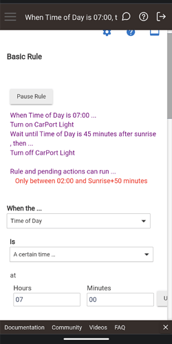

Here's an option
Define Required Expression
Time between 2:00 AM and Sunrise+45 minutes
Select Trigger Events
When time is 7:00 AM
If Sunrise+45 minutes is before 7:00 AM the rule won't trigger.
@user1270 if you choose to use my suggestion, there is something that you need to consider. If sunrise+45 is 7:01, do you really want the light to be on for only 1 minute? I think anything less than 5 then I'm not turning on the light. If you're using a Wait command to turn off the light at sunrise+45 then when sunrise+45 is 7:00 you'll miss the wait and the light will stay on until the next morning.
For the light to stay on at lease 5 minutes, I would suggest modifying the Required Expression to:
Required Expression
Time between 2:00 AM and Sunrise+40 minutes.
Then turn off the light at sunrise+45
If you're okay with the light only being on for 1 minute then you can keep the Required Expression as sunrise+45 but I would suggest the actions as
Selection Actions to Run
On: Light
Wait for events: When time is Sunrise+45 OR When time is Sunrise+46 minutes
Off: Light
This will catch the sunrise+45 = 7:00 AM case and turn off the light at 7:01.
