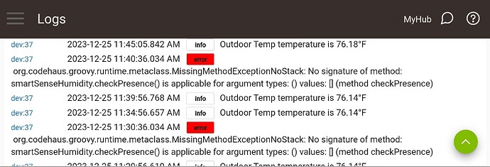

I've been using the centralite 2310-G temperature and humidity sensor for some time, using the Smarthings Humidity sensor driver. Seems to work properly, however I see a repeated error in the logs... Is there some fix, or a better driver? See pic
Is this a custom driver? Were you using a different custom driver before? If you temporarily switch to the "Device" driver and run the "Delete Scheduled Jobs" command, it would likely address at least the latter case.

No, but there is no harm the above step should cause. You could even just go into Logs > Scheduled Jobs and delete this particular job if you don't trust the driver, though it does nothing on its own and would only do the specific commands you run.
