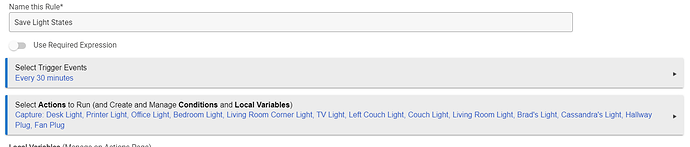

I have several capture and restore rules that I created, with the purpose of bringing my lights and outlets back to their previous states following a power outage.

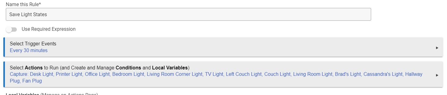

I have a rule that runs every half hour to capture the state of my lights and smart outlets.

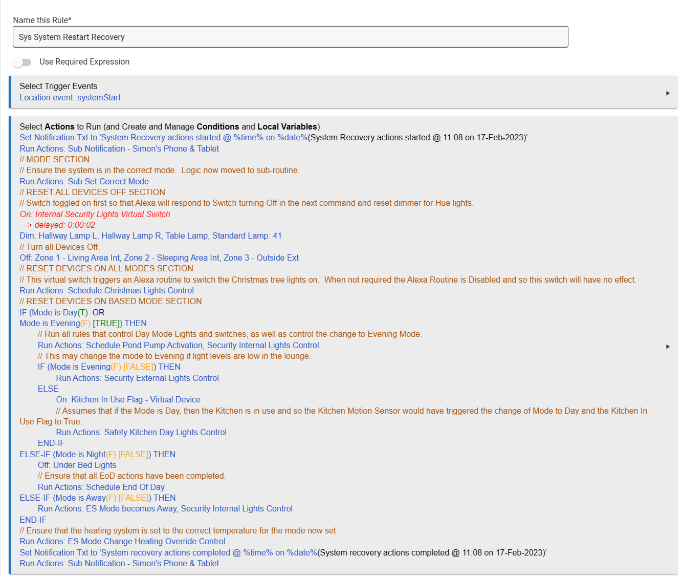

I have a similar rule but rather than capture the state of lighting on a 30 min schedule, I re-run the rules that set the lights in the first place. To get this working, I've had to change some of my rules so that they run correctly when they are 'called' and not triggered by their 'trigger event'. Here is my System Restart Recovery Rule:
This approach resolves the issue that @Slate identified.

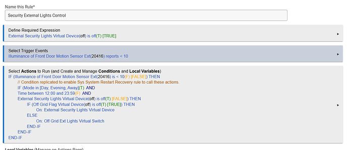

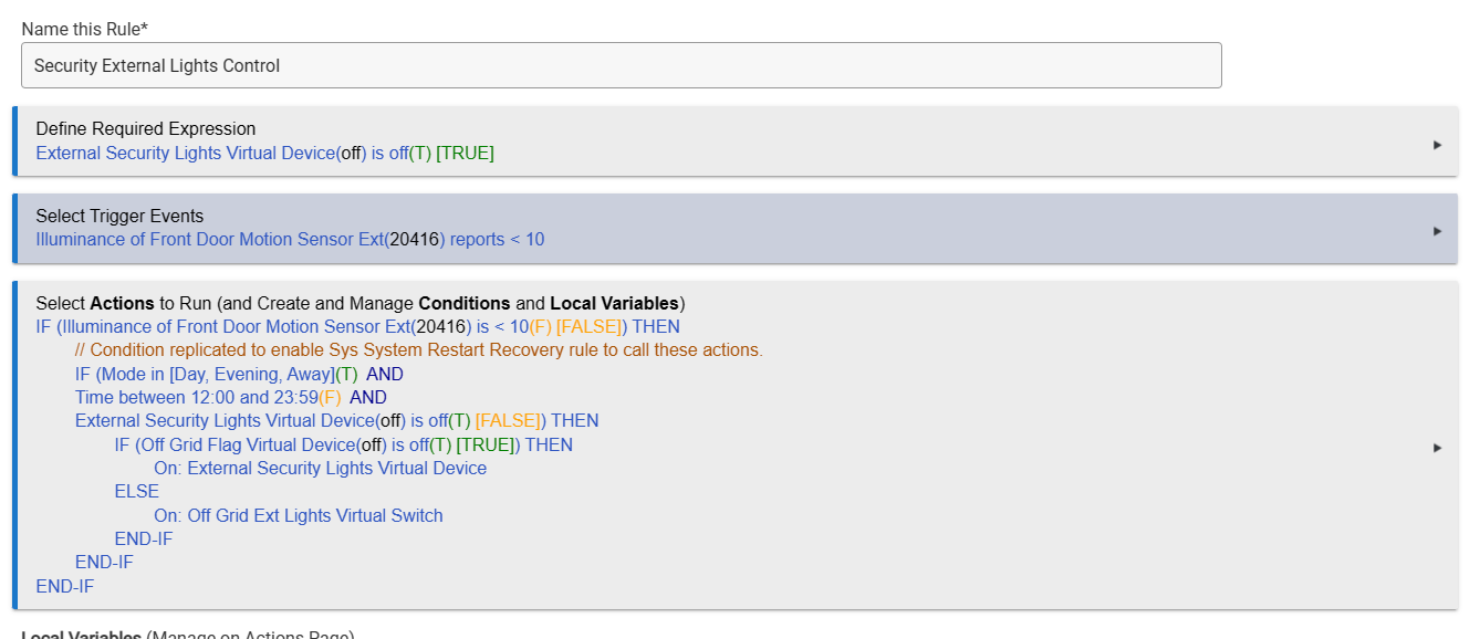

Here is my Security External Lights Control rule as an example:
Many of our smart bulbs don't support the "Power restore state" config option, so they come on when power is restored at any time of day.

But "Capture" saves states into that particular rule. It's looks like you are spreading this across at least two rules. A capture is only meaningful if restored from the same rule.
