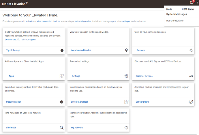

One of my hubs 'USA 42' wont upgrade to latest 2.2.6.133. Was running fine on 131.
It never completes the update but if you access the hub it has a startup page (below). But every button eg Settings just redisplays this page. Online find.hubitat.com finds the hub OK. The startup % never shows ie 20% 25% etc. But the UI below does after a time
At port 8081 it shows 133 and I can revert successfully revert to 131 but still can't update as such.
