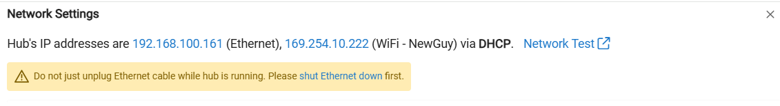

My Hub is usually on the 192.168.100 subnet.
I tried to connect the Wi-Fi to my 192.168.200 subnet.
The first image is what I saw. Notice the address 169.254.10.222 which does not match my subnet.
Also notice the message "Do not just unplug Ethernet cable while hub is running. Please shut down Ethernet first. I clicked on that link, and became disconnected from the hub.
I connected to findmyhub,hubitat.com, to find the Wi-Fi address that the hub was using, and then connected to that with my browser.
The 2nd image shows that Wi-Fi is working properly.
