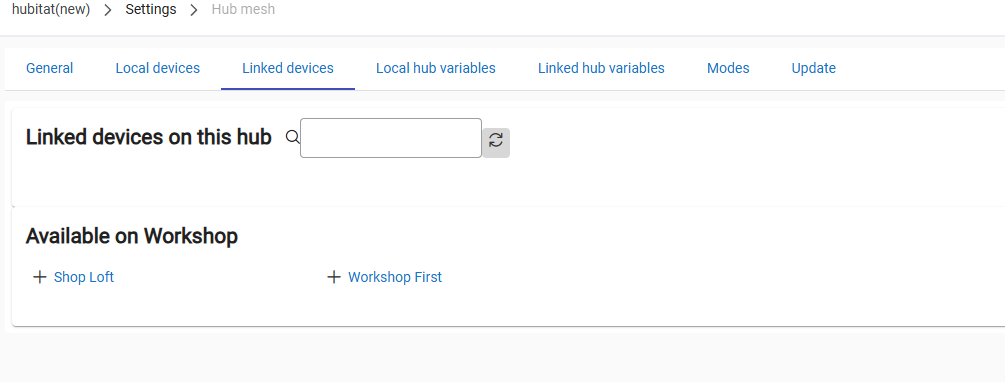

Devices that I've shared on a remote hub ("Workshop) show up as "Available on Workshop".
The documentation says to click on the + symbol to "add shared device to this hub". But, when I do that, the browser redirects to the Device Information page for the device, but the device doesn't get "linked". It doesn't show up in the list of devices.

Are you really clicking on the :heavy_plus_sign: or on the words? You must click the actual :heavy_plus_sign: symbol to link the devices. The words are a link which takes you to the device in question, but does NOT link the device.
I thought tried both, but apparently that was the issue. Clicked on the + and the remote device show up.
