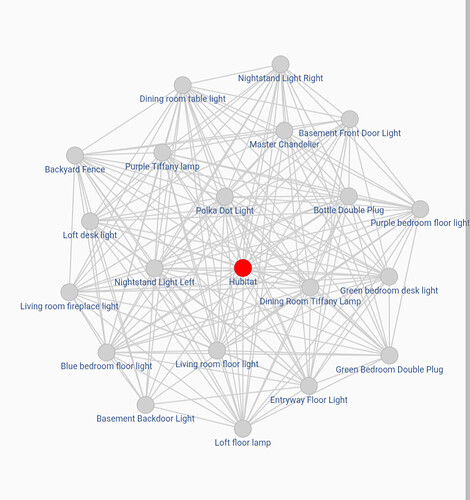

All of these devices pair fine in classic inclusion mode, and my network has 20 Z-Wave 800 devices that all respond. There's no Ghosts as far as I can tell either.

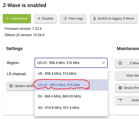

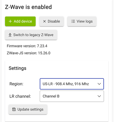

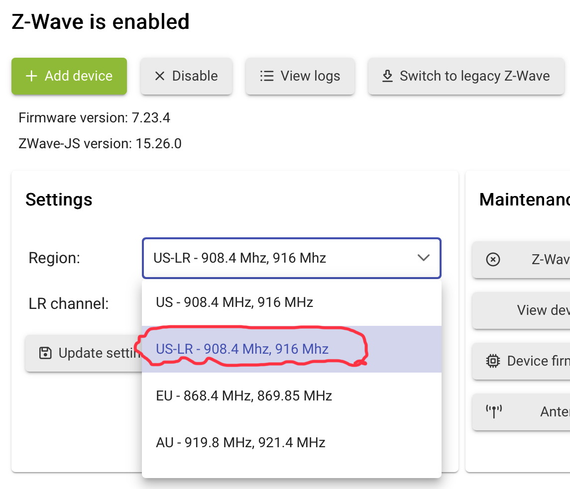

Assuming you’re in US, have you checked this for LR/
Those settings are the defaults (and is set for LR)

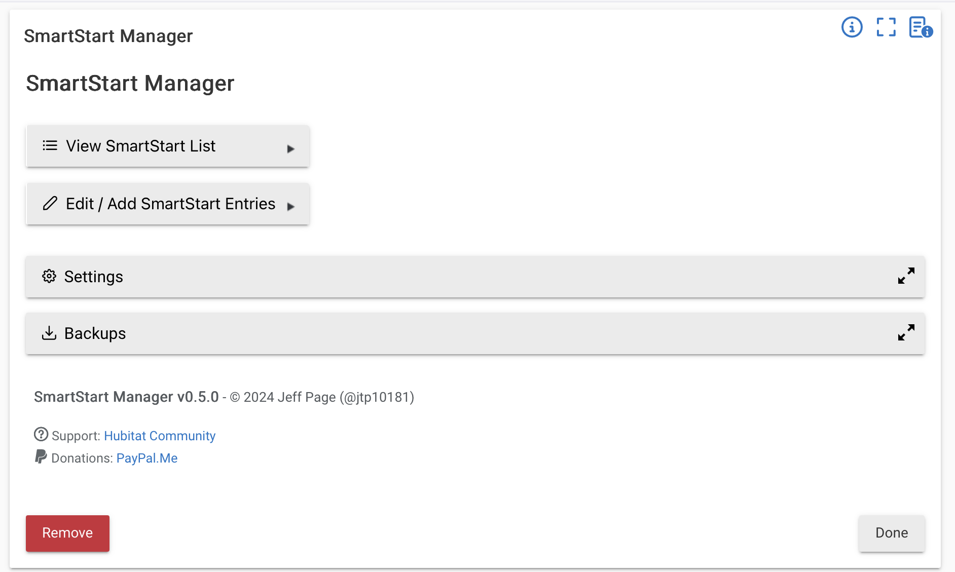

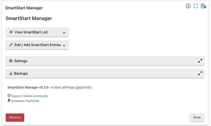

Have you tried using this by Jeff Page?
