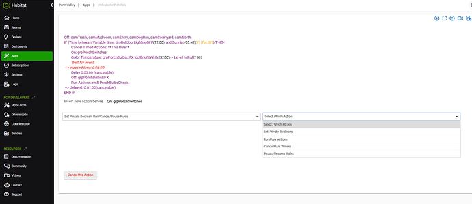

In my search of the Community, there appears to be a difference between Cancel Timed Actions and Cancel Delayed Actions, the former being the more nuclear approach. However, when I select "Set Private Boolean, Run/Cancel/Pause Rules" from the Select Action Type dropdown, I only see "Cancel Rule Timers" as a Cancel option. What am I doing wrong?
That's the one you're looking for. The name changed a while back (as it can affect more than just actions--and because of that, it's less likely you really need this, so if you aren't sure, sharing more about your axtual rule may be useful).
That will work for my current situation, I just didn't find anything that said "Cancel Delayed Actions" had been deprecated. Thanks.
It hasn't been...
Are you looking for that instead? You didn't mention that in your post. It's under "Delay, Wait, Exit or Comment."
Good to know, thanks. I figured the topic title "Can't find Cancel Delayed Actions" and "What am I doing wrong?" as the last sentence implied I was looking for it.
Sorry, I misread! I thought you were asking about Cancel Timed Actions that you had read about, which is what my initial response is referring to.
