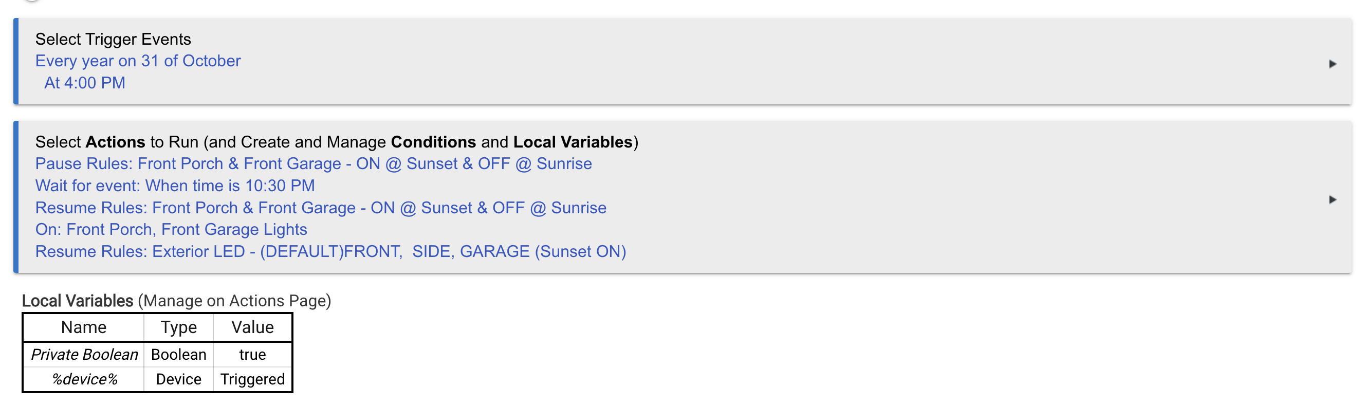

I setup a rule to run every year on October 31 and it did not run. I am befuddled as to why??
Can anyone see what I did wrong. Thanks!!
Looks like it should have. If you go to the settings page, gear icon at top of rule page. is there a scheduled job for next Oct 31st?
Yes there is a schedule setup for 2023.
"periodicHandler 2023-10-31 4:00:00pm PDT PENDING 0 00 16 31 OCTOBER ? *"
When did you create this rule?
Not exactly sure. About a week ago... Is there a place I can look?
Looks like there is a bug, See here.
Thanks for the link. Hopefully the next update will fix the issue.
