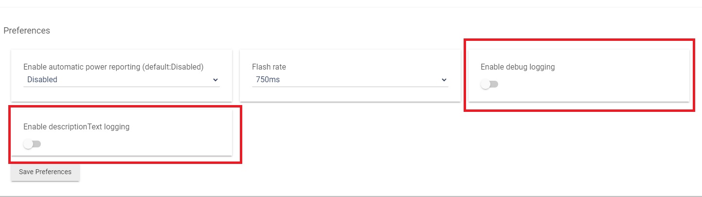

One thing I found annoying is that when the debug log is turned on for this dimmer, a job is automatically scheduled to run in 30 minutes to turn the debug log off. Wish there was a way to keep it on, or at least keep it on longer.
This is done because, more often than not, people won't think to turn it back off (or adjust the amount of time if given the option) and it'll cause headaches as the device fills up the logs. That, compounded by the number of devices added.
There are debug logs, and text logs. The debug logs output a LOT of stuff, and it would just fill the logs with (mostly useless) info. The regular device text logs give enough info to be useful without being overwhelming, and they stay on until you decide you don't need them. I don't think all drivers have this option, but many do.
