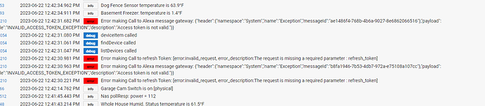

trying to add the echo skill.. worked ok in hubitat but when i try to enable it and select the device in the alexa app i get the following..

I suggest to remove the integration then go to Amazon's Alexa app and enable the skill from their side.
thANKS trying tat
thanks reboot of hub and remove and readd fixed it..
