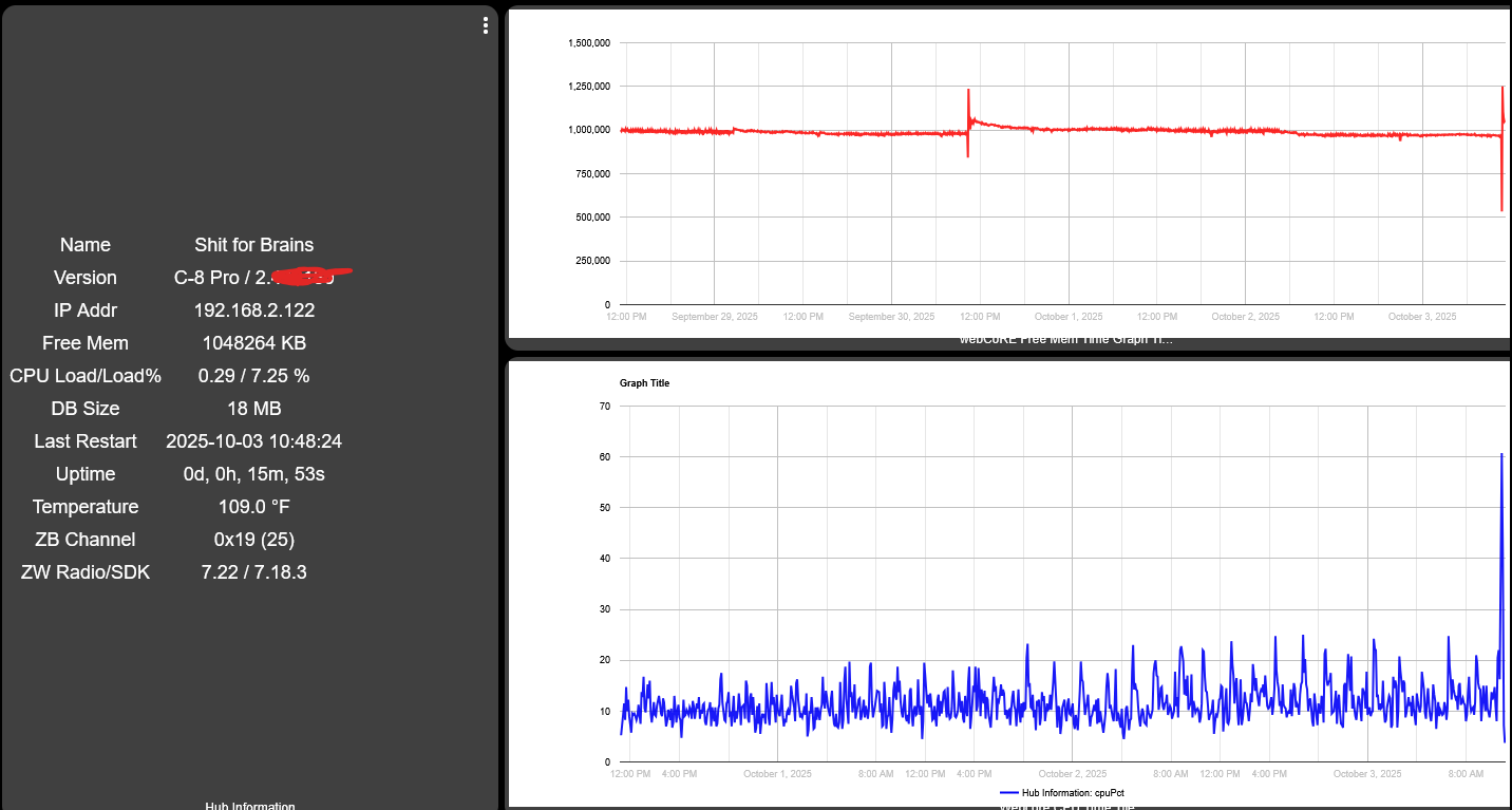

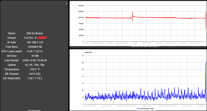

setup a memory graph on a dashboard... See how it is when it crashes
Thanks, I will look into setting up a memory graph. Update: I got direction to do a soft reset and backup the database. Did so, but after booting the hub was not able to control z-wave devices. I watched the app stats and devices stats drop to normal levels. However, after a time the settings page would no longer respond. Shortly after that, the hub returned to being unresponsive, no diagnostics page, but responding to pings. Was asked for MAC address and provided it yesterday, waiting on next steps. Hopefully will get some good direction soon. I am guessing this is a weird one. Thanks all.
