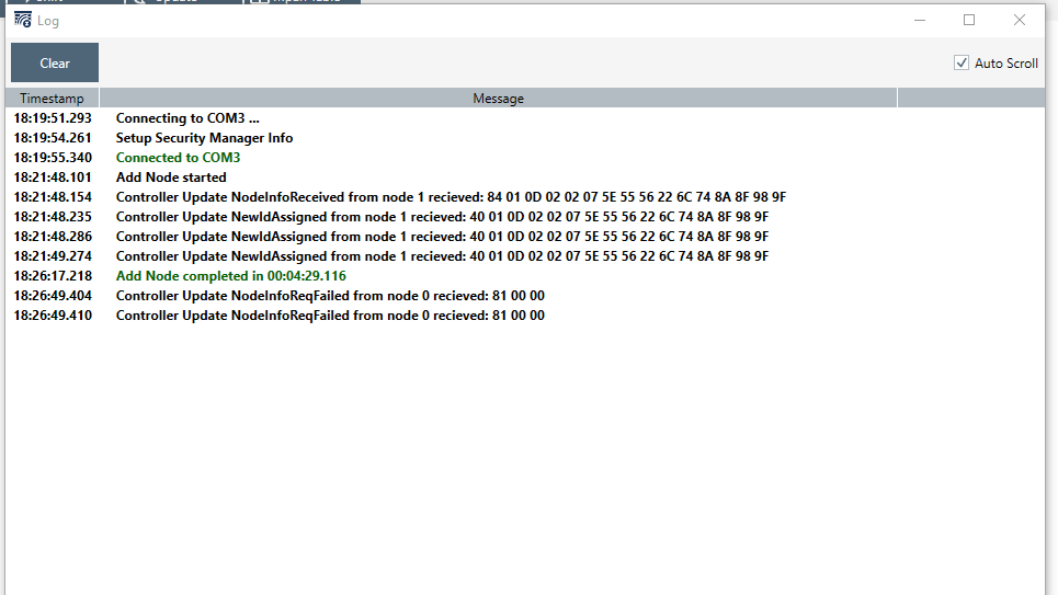

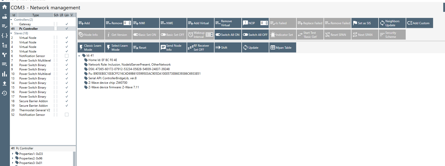

Here's how it looks. I'm pressing the "Add" button, and putting the sensors into inclusion mode (sitting them right next to the hub, or the digikey stick yields the same results)
This is the dialog I get- it seems to start, does nothing for a long time, then states add node complete with no further information.
The node shows up in the controller software as the correct style, but does not exist at all in hubitat. I've done this multiple times with 2 different sensors, I've cold rebooted both the hub and stick several times. I have on occasion seen a longer dialogue that looks more promising, and then shows a device in hubitat, but it is always an unrecognized device that I can't use. They pair easily with the native hubitat interface, but being a C-7, I can't opt out of the S0 security. And yes, I've been removing the sensors with the PC controller after every attempt. The remove seems to go very smoothly, and it has worked to take some ghosts out of my network.

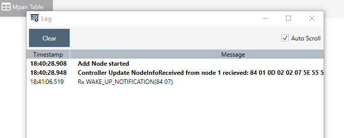

And sometimes I get this, presumably when the sensor goes out of pairing mode. I've tried waking it back up with one button press, or restarting pairing mode, to no avail on either.

After the device was paired, I clicked on it on the left and then clicked on the “Security Scheme” button. If I remember correctly, I then selected “None” from the security options.

OK, thanks so much- that worked like a charm to get the device into hubitat via the stick! I'm still a little unclear how I downgrade it's security now at this point. I can select the node, pick "Security scheme" (which by default is blank), then select none. It lets me do that, but there is clearly no communication being sent out when I do, and no change in hubitat. Is there some sort of a "send new security level" or something like that I need to send out.

Yeah, reboot didn't change it. There's a "send node info" button on the controller that seems like it might be the key, but it just tells me that the send info is queued, but that there is no assigned wake-up interval (I assume as it's a battery device). Does that ring any bells? Do I need to assign a wake up interval to get them to talk to each other to send out new info?

2- Hit the shield icon in upper right on the PC controller. Deselect "enable S0" but leave the rest enabled (otherwise the controller loses its security permission to add devices).
