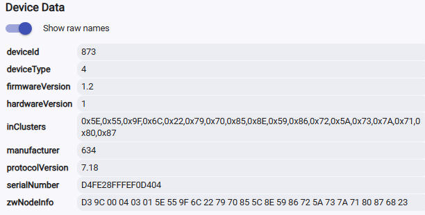

Cannot update firmware on Zooz ZSE50
C8 firmware 2.5.1.158

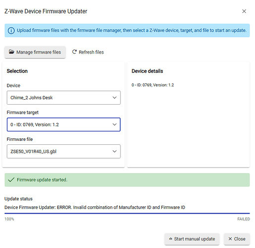

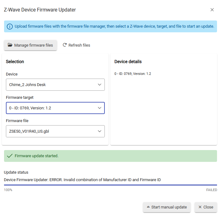

I downloaded the file from ZOOZ, Copied to the hub. Ran update firmware from the settings / Z-Wave screen. Get an error code (see below)
I cannot change the Firmware Target entry.

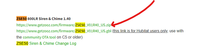

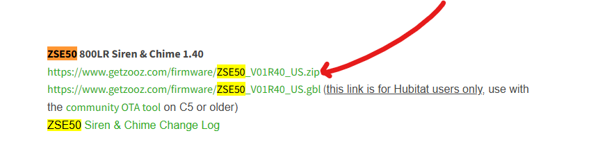

Firmware file can not be a zip file.
I uploaded the extracted GPL file not the zip file.
I had one to do today and it worked without issues. I'm on ZWJS. Maybe try shutting down/wait 30 seconds/restart the hub to re-start the Z-Wave radio?
I'm on ZIP with a C8pro and mine is progressing right now, waiting to see if it fails.

Shut down hub, restarted and the update worked with no issues.
