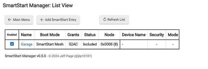

Post a screenshot of the SmartStart Entry you have for the device. Here is my two locks of the same model for example. You will want Mesh mode and S2 Access Control grants.

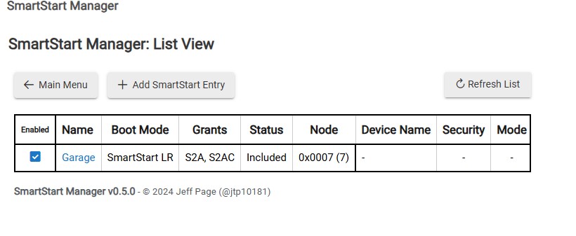

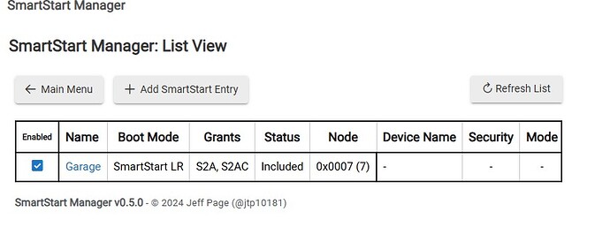

Thanks for your reply. The hub is powered by the supplied power cord. I just bought it this week along with the lock. No other Z-Wave devices that I know about. But there may be some. I did install the app and got the screen shot below:
If you cannot access the pic. I have S2A and S2AC selected for the lock and do not have SmartStart Mesh as an option when assigning attributes. If that is bootmode, I have SmartStart LR assigned.

I don’t think LR mode will work for that device? It needs to be in mesh mode or it will fail. According to that it already is included as node 7 but no device got created. You might have a dead node on the radio now. You need to check settings, zwave details. Need to clear out any failed pairing before moving ahead.

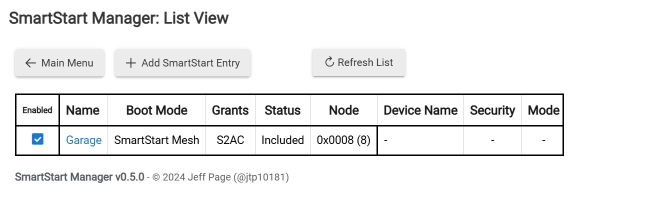

I did the steps listed above. There wasn't a record in the Z-Wave Details when I took that screenshot. Only a record in the SmartStart Manager App. When I performed the steps, a record did show in the Details and then this one showed in the SS Manager just like the ones you had listed:
I noticed its on Node 8. When I checked Zwave details there was a record for the lock on Node 7. No Device in the Device Manager. So I deleted out the Zwave Details record thinking it was a ghost? Should I try the process again? Provide a log? If so which one? Thanks
