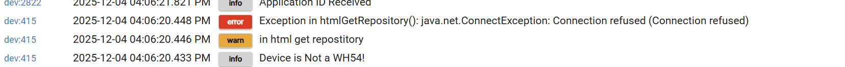

when i do the url from a browser it works fine.. when i try from a device i get the following error
i have tried both http://127.0.0.1/local/file
and the actual ip..
any ideas thanks
and the actual ip..
any ideas thanks

got it to work like this..just strange old one changed to 127.0.0.1/local should have worked the same
// String repositoryText = "http://mail.lgk.com/ecowitt1.css".toURL().getText();
def byte dBytes = downloadHubFile("ecowitt1.css")
def String repositoryText = new String(dBytes)
