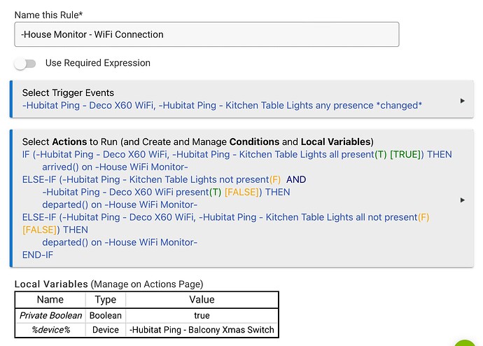

This is the rule with the [-Hubitat Ping - Balcony Xmas Switch] removed and replaced with [-Hubitat Ping - Kitchen Table Lights]. Note that [-Hubitat Ping - Balcony Xmas Switch] appears as a %device% in the Local Variables list. It was never added as a local variable to begin with when the rule was originally written but somehow shows up anyway (could it be associated with the community Hubitat Ping driver?). After I removed the device from the rule, I saved the new version of the rule by clicking done.

Note that I never set up a local variable that used the old device as a local variable (it just showed up). Perhaps this is related to how the community driver works?

What's showing in the Local Variables is %device%, that this was the last device to trigger the rule.

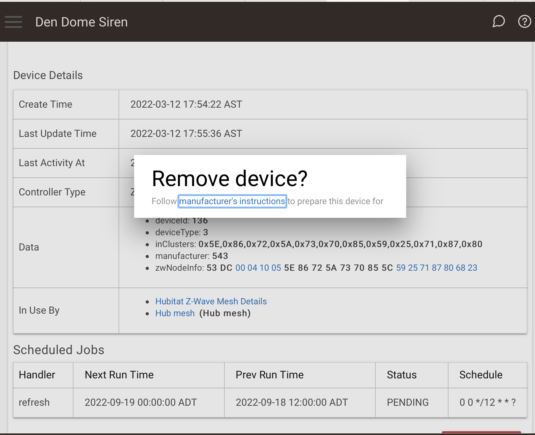

@gopher.ny, I think I’ve seen this before and forgot to report it. The pop-up is scrollable, so it appears as if the button to remove the device is not in the pop-up, but it is actually hidden as there is more text than can be displayed on the pop-up, but this requires scrolling. (On the iPad / Safari, this can be done with a finger on the pop-up. I suspect the scroll wheel would work on the PC.)
Here’s a couple of screenshots to help show the issue.
The first one shows what appears:
The second one shows what happens when you scroll within the pop-up:
@moh, can you see if you are able to scroll within the pop-up?
Hi @Sebastien, I checked on another test device and I cannot scroll within the pop-up when accessed through the Hubitat App. I am accessing on an iPad using iOS. This may indeed be part of the problem. @bravenel and @gopher.ny ? Any fix for this or is it solely a limitation of iOS or the app? Looks like a bug to me? Thanks for pointing this out @Sebastien .
It’s unfortunate that you’re not able to scroll… But it might indeed be an iPad issue.
