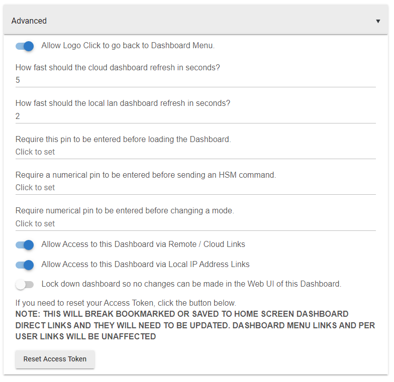

The dashboards show up in 'Apps' too. You can check the Advanced section to make sure local access is checked.
You can also see the direct links for the local and cloud links to the dashboard and can try them out directly just to make sure there's not something weird going on just in the Dashboards tab.
