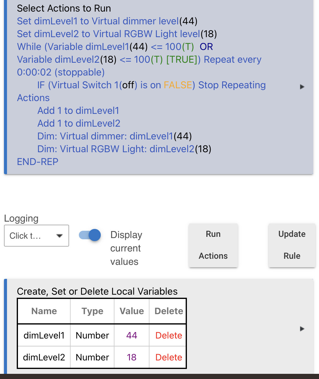

One option would be to do the following:
You could have it in a single rule like the screenshot, or have one rule per dimmer which would be quicker to build as you could just create it once and clone it for the others.
You would need to adjust the while’s repeat interval to one that works for you. I had it to 2 seconds to test it.
I would also recommend that you remove the if condition that you currently have and add the equivalent in “Use Required Expression”. It would make your rule easier to read since you will be making it more complexe.
Finally, if you want to be able to adjust the dimmer manually while it is going up, you could move the “Set dimLevel to …” to after the “While…”.
Let me know if you have questions!

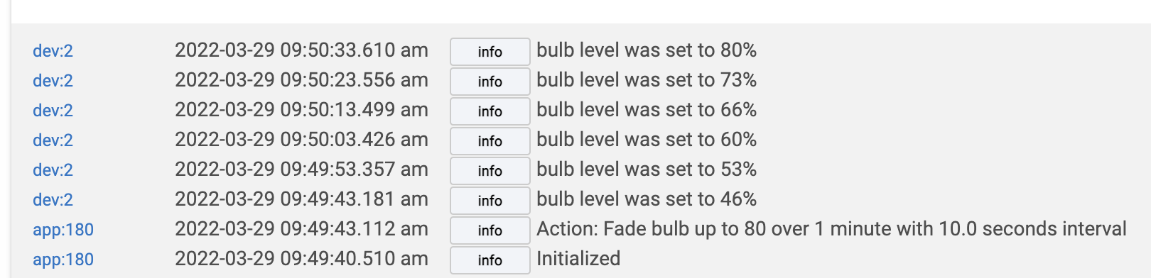

@bravenel, should the fade up over time command set the dimmer to zero and fade up from there or start fading from the dimmers current dim level? If it is working as intended can we get an option to fade up/down from the current dim level?
It starts at the current level for the device.
This dimmer was at 40:
My rule sets the dimmer to 30% and then is supposed to Fade up to 99% over 20 minutes.
But the logs show it being set to 30% and then almost immediately set 1% and then starts fading up.
Am I using the rules wrong?
