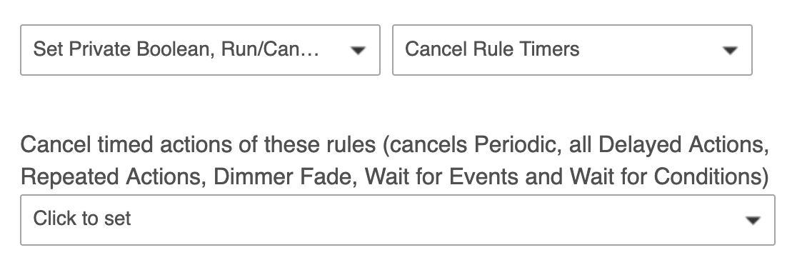

"Cancel Delayed Actions" won't work for the "Fade dimmer over time" thing (that only works on delays, either the "Delay" action or the "Delay" option on an action), but there is one that will work: "Cancel Rule Timers." See below:
