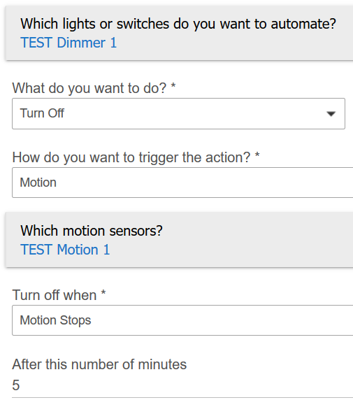

The rule above looks good to me (following the new paradigm suggested in the last Hubitat Live episode), but while Motion Lighting might not work, I'm not sure you need to resort to RM if you don't want to. Simple Automation Rules (formerly Simple Lighting if you're on 2.1.9 or earlier) looks like it could do this, too:
(Confession: I have not tested this, but it looks like it should work and I'd consider it a bug if it doesn't.)
