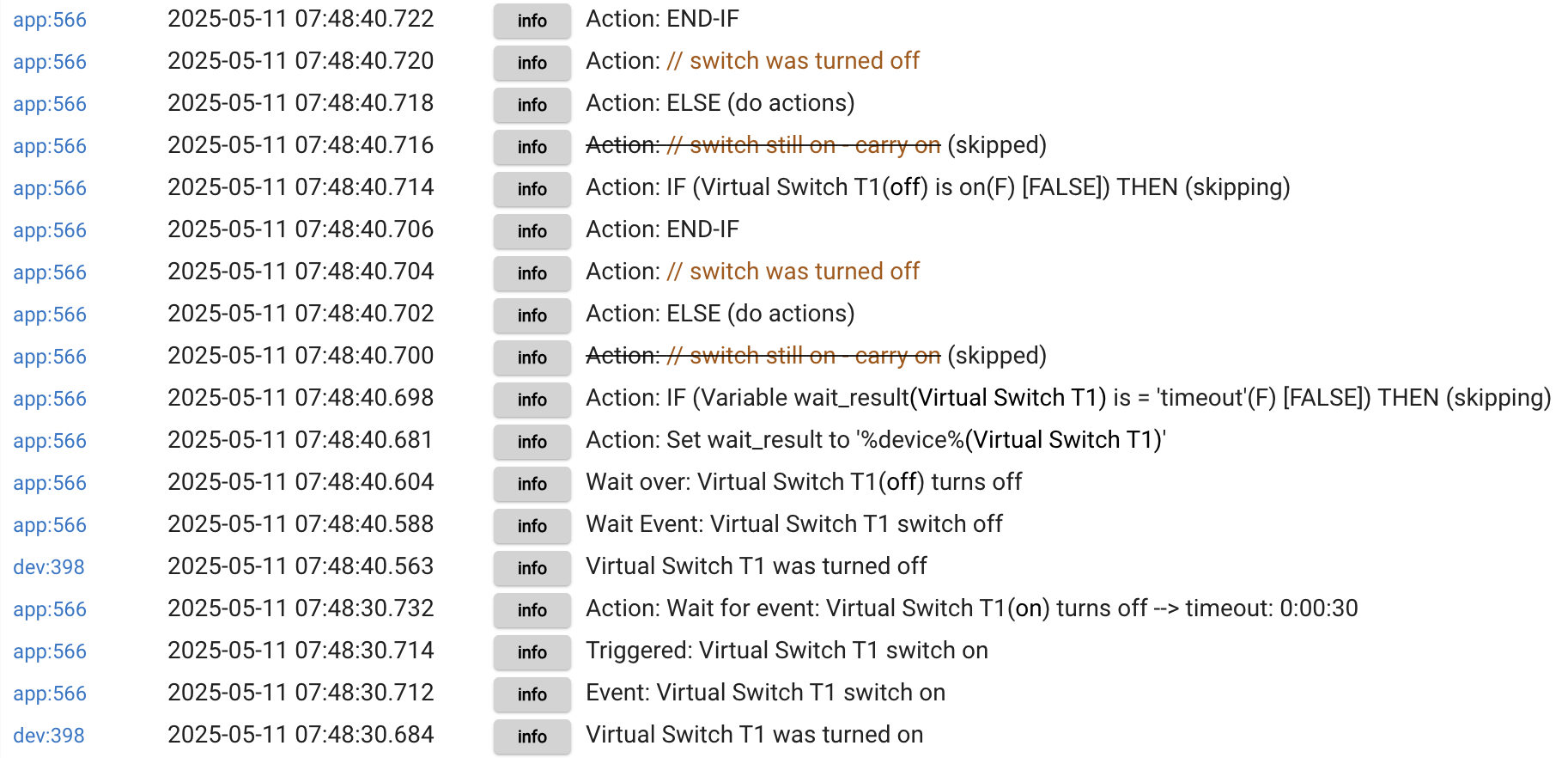

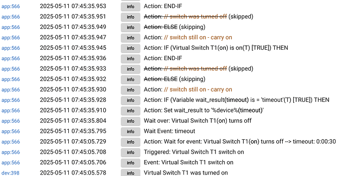

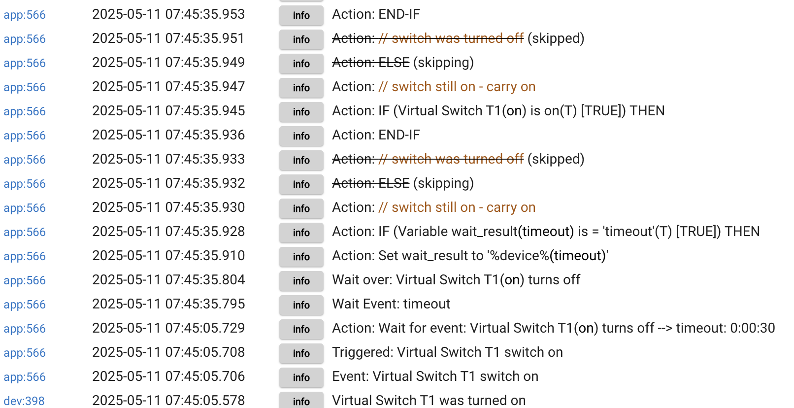

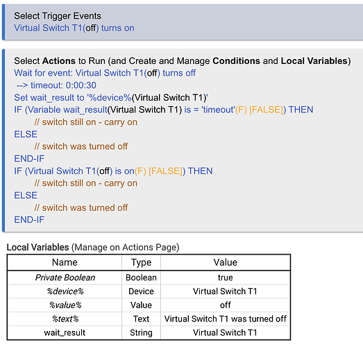

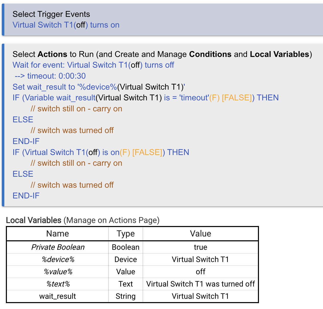

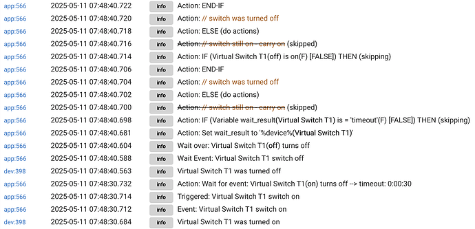

Here is an example for both ways to do it (of course you would pick one):
With switch staying on beyond timeout:
With switch turning off before timeout expires:
Aaaah!!! :sweat_smile:
Oooohh! :grin:
Ok, now I get it. That's really cool.
THANK YOU!
