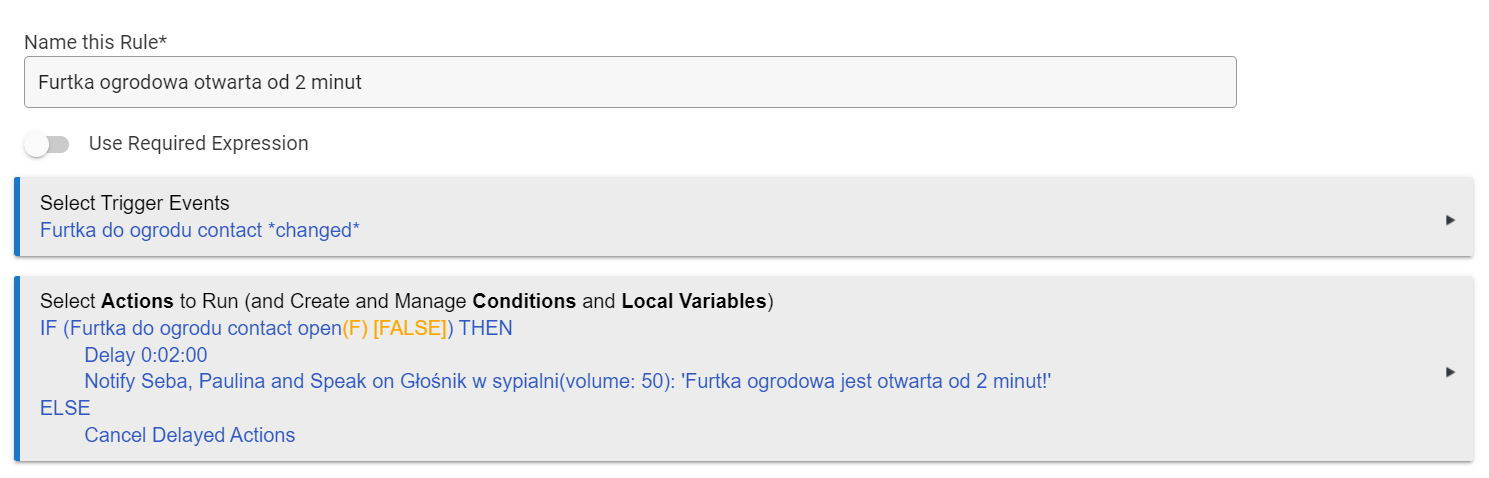

Similar rule worked in RM4.0 properly. I created new rule as below in RM5.1 and it doesn't work.
What I want to achieve is to get a notification when my garden door is open more than 2 minutes (then propably somebody forgot to close it). But I want to cancel notification if garden door is closed within 2 minutes.
Similar rule worked great with my garage door in RM4.0. The only difference there was a time - 5 minutes instead of 2.
What's wrong?
Edit your Delay and you should see a slider to make in cancelable. Without that selected the Cancel Delayed Actions won't work.
And add an END-IF to your IF-THEN action
Or you can use a Wait for Event Elapsed time. With a wait you don't have to add the cancelable option as waits are automatically canceled when a rule is triggered.
