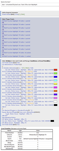

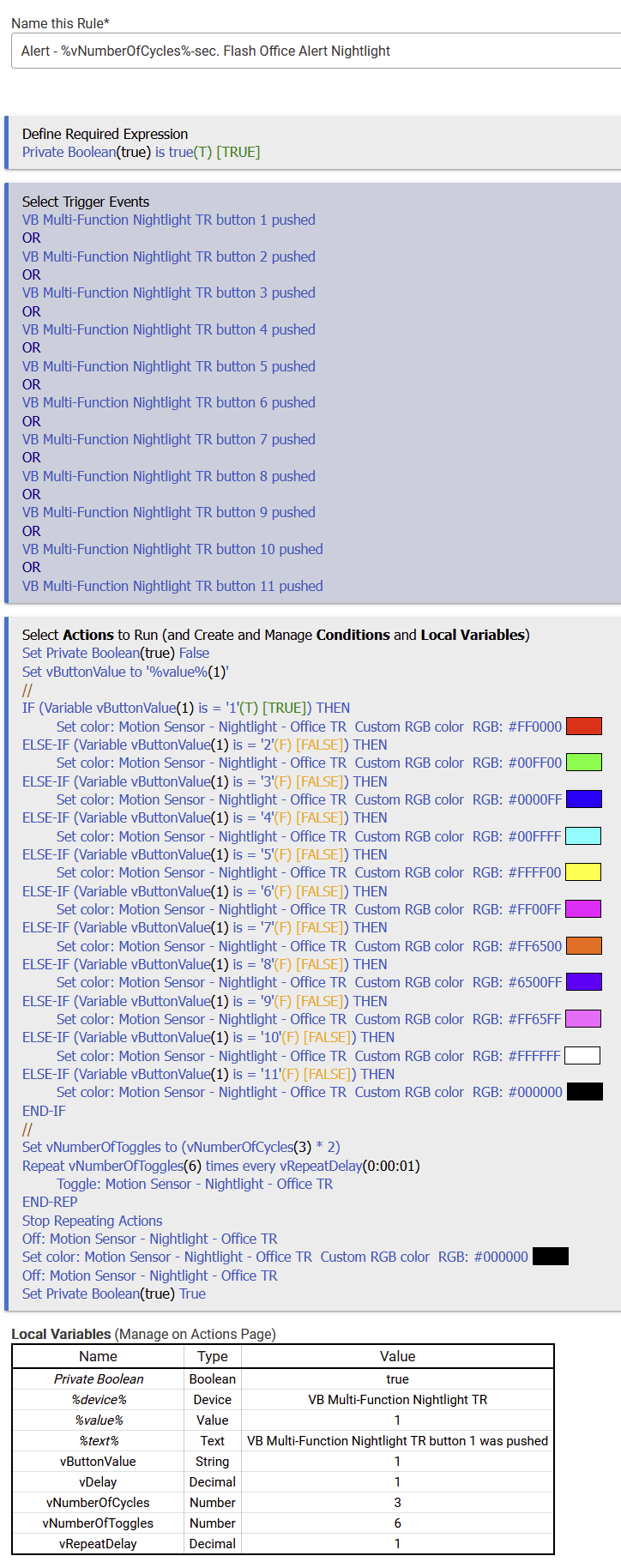

Virtual buttons allow you to choose the number of โ€œbuttonsโ€œ, and therefore the number of states, the control can have.
Here's an example rule that flashes a selected color for about 3 seconds on a Third Reality Multi-Function Night Light, using a 12-state virtual button (only 11 states are used as triggers in this example):

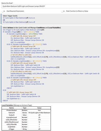

Here's an example of another approach: activation of a virtual switch repeatedly cycles through 4 states (in this case, to control 2 different light sources, but easily modified to set a fan speed). Note that the variable vLightState persists between invocations of the rule.
EDIT: note that the virtual switch in this example uses the "Virtual Switch uDTH Lite" driver with Preference "Force State Update" enabled.

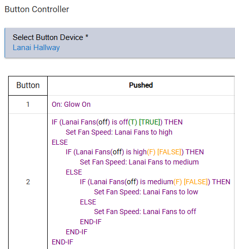

I have this logic in a button controller to step through fan speeds, off, high, medium, low, off, ...
You could just swap in you two switch actions
Off turn off A & B, High turn on A & B, Medium turn on B turn off A, low turn on A turn off b....
