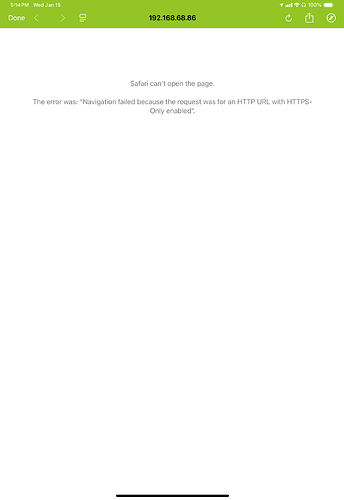

Do you have HTTPS-only mode enabled on your hub?

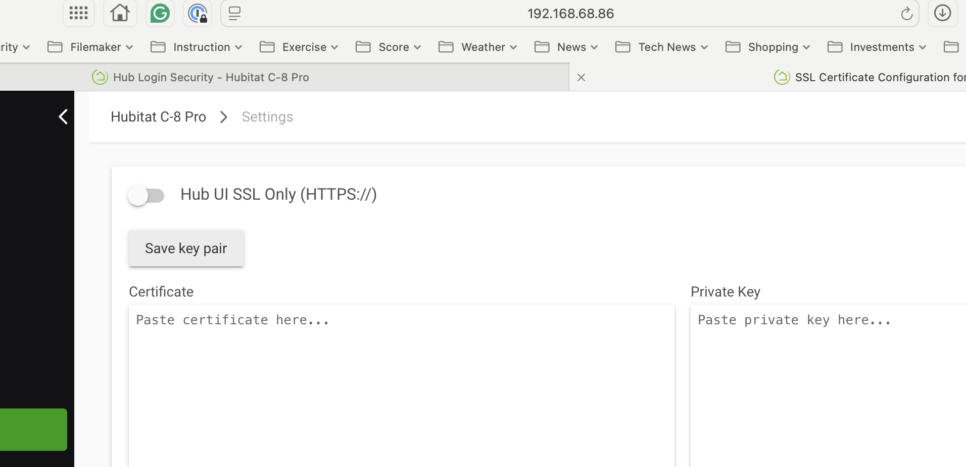

This would be under Settings > Hub Login Security > SSL Certificate Configuration for HTTPS, toggle at the top. Guessing that having this on could be related...
is the IP address shown at the top of that screen correct? What happens if you hit the Safari icon at the top to open in the real browser?

What about this, in particular the Safari icon you see at the top of your screenshot?
Originally I that’s what I thought, the ip had changed. It had not. I also tried enabling HTTPS only and reverting to the original config with no change in the results
I also considered I was seeing cached pages with the error. I used a computer that has never been connected to Hubitat with the same results.
