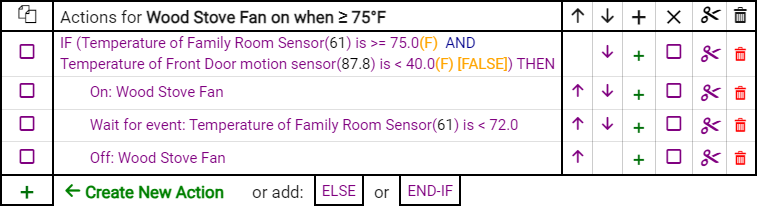

Can someone verify (or correct) this rule?
I'm working on moving my rules from Simple Automation Rules to Rule Machine as a learning opportunity, but there's one that I don't want to have to wait until next winter or concoct hokey conditions to test. Hoping someone more experienced can tell me if I'm on the right track.
In a nutshell, we use a wood stove in our lower-level family room during the winter. When the room reaches 75F, a simple automation turns on a fan to push heat upstairs until the room eventually drops below 72F (usually overnight). To avoid running the fan when the room gets warm during other times of the year, I currently disable the automation in the spring and turn it on again when snow arrives.
The simple automation works great, but I'd like to add another sensor to the logic so the fan will only run automatically if it's below 40F outside; then I wouldn't have to enable/disable the rule seasonally (and I'll learn something as well). Will this do it, or have I got it completely wrong?
Thanks in advance for any guidance!
~Brent

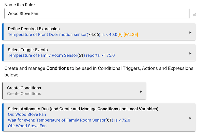

Thanks to both @TArman and @JB10 for your input. I think I've got a handle on this. Hadn't even seen the required expression option. This is what I've got now:
Look right? Thanks again!

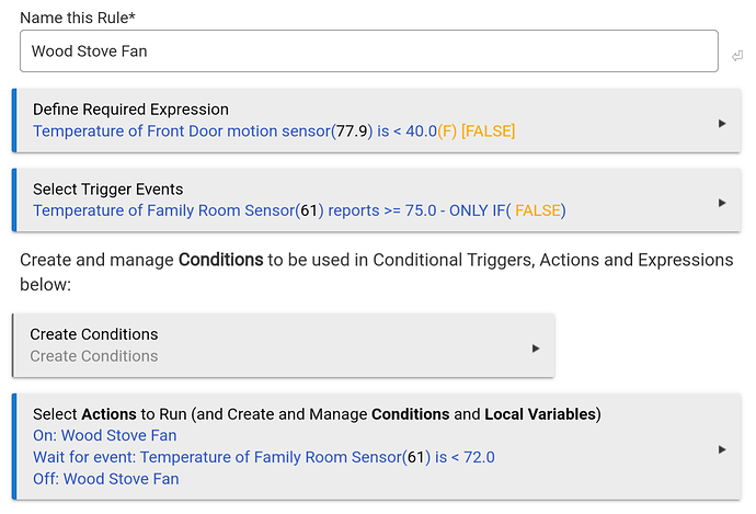

Not quite -- you set up a conditional trigger, but didn't provide a condition for it, so that's why it says False in you trigger
Conditional triggers are a pretty new feature... Painting with a broad brush, you typically would use either Reqd Expression or a Conditional Trigger, but not usually both.
In this case, I'm thinking you don't need the conditional trigger -- just use sensor temp ≥ 75 alone.
ETA a few tips...
Triggers are always events, and Conditions are always states.
A Required Expression is kind of like a gatekeeper to the rule -- when it's false, the trigger won't fire even when that event occurs. So the rule is only "alive" when the RE is True, and it's dormant when False.
A Conditional Trigger is evaulated every time the event happens -- if the Condition is True at the time of the event, the rule fires. So here, the rule is always alive.
That may seem like a minor nuance (and it likely is in many cases), but for events that happen a lot, a Required Expression can really help keep traffic & noise better under control.
Whoops! I posted the wrong screenshot. I actually caught that when I was cropping the image and went back and changed it but then proceeded to post the old screenshot anyway. :man_facepalming::sweat_smile:
Thanks just the same for noticing and providing the detailed explanation. I'm here to learn, so it's much appreciated.
