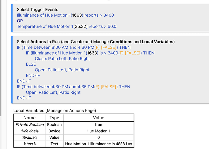

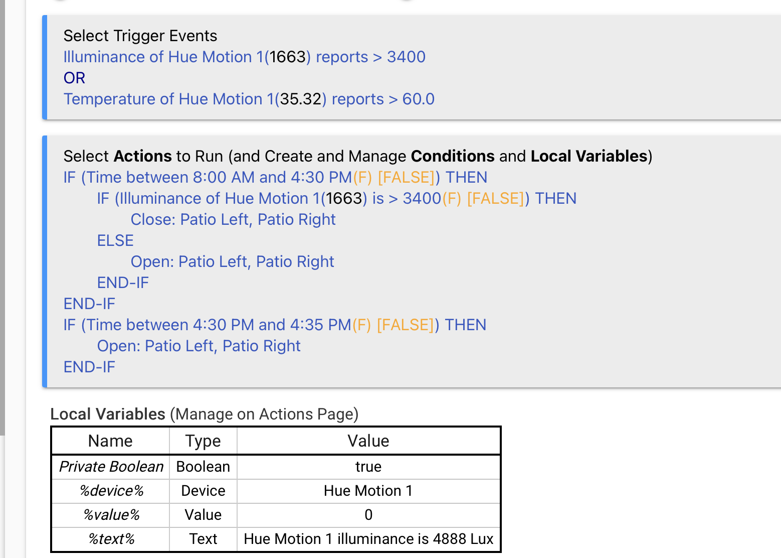

Can someone help me with this rule
I am trying to make my blinds come down, when the sun or light level hits an illuminance, during certain times, and then of not that illuminate, rise up again.
here is the code I am using. Thank you.
This screenshot is a rule machine rule, not computer code :slightly_smiling_face:.
But I get it, it can all seem like Greek to non-programmers (myself included).
My first question is why do you have two triggers, with one of them being based off of a temperature sensor reading?
