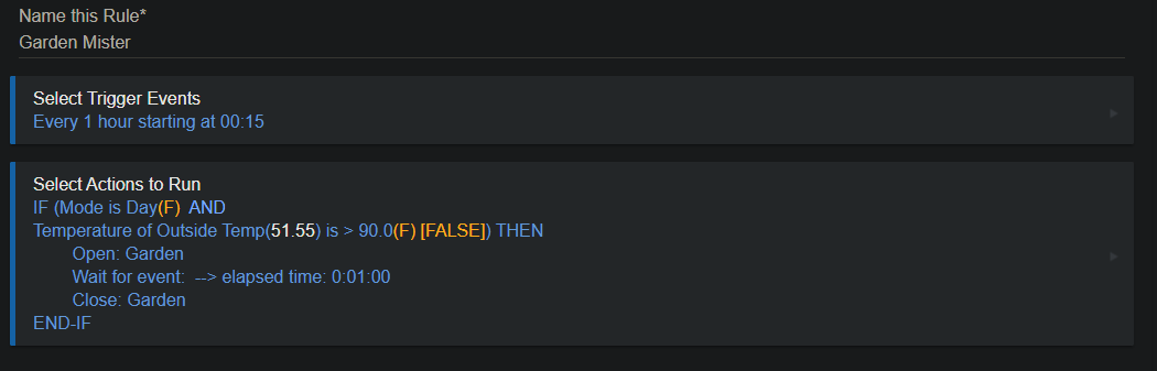

Repeats confuse me too, so I won't be much help with that. But I've found a way to do similar things without using repeats. You can have a rule trigger on a periodic schedule. You can either do every so many hours or minutes, or at specific times throughout the day.
For example, something like this will check the mode and temperature at 15 minutes past every hour and if the conditions are right will open the valve for one minute.
based on your trigger, it'll only happen when your mode becomes day. if the temperature increases after you've switched to day, your rule won't run. also, your repeat is only checking every hour to then cancel everything. you're only watering once.
you could try something like:
trigger: On every hour
action: if (mode = day && temp > 90) then
turn on misters
turn off misters -> delayed 0:01:00
end-if
this way it checks every hour and will do it only if the temp is above 90.
like this
