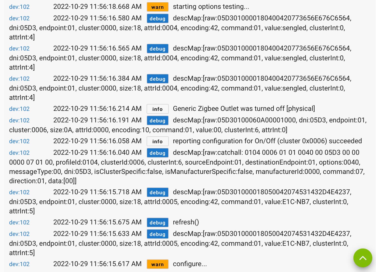

They’re Zigbee Sengled E1C-NB7. I am logged into my hubs IP address and I select the device in my device list. I’m not sure where to find the logs.

Is this what you’re looking for?
You can turn off debug logging for dev. 102 (Outlet 1).
Then unplug it, wait 30 seconds, and plug it back in.
Now try controlling it from the hub. Does it work?
