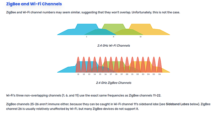

Basically your "standard" Wi-Fi and Zigbee networks operate on the same frequency, 2.4GHz, with many routers nowadays offering a 5GHz network as well. Think of your Wi-Fi frequency like changing the station (frequency) on the radio in your car. There is then a further breakdown of the communications at the 2.4GHz frequency into channels, typically 1 - 22 or so... With the 5GHz frequency including channels much larger. Thee are then channels that are best chosen together for adjacent networks (i.e. those that exist alongside each other in, say the same household), to avoid collisions in communications, but I might leave that for you to investigate further,,,
The famous cross reference chart:
  1. don't forget to make sure that your own wifi and your own zigbee channels are not conflicting with each other.
  2. to determine your wifi channel (and your neighbours) use the app on SmartPhone called "wiFi Analyzer"
  3. To determine all the zigbee channels that re being used , under zigbee details use "channel scan"
