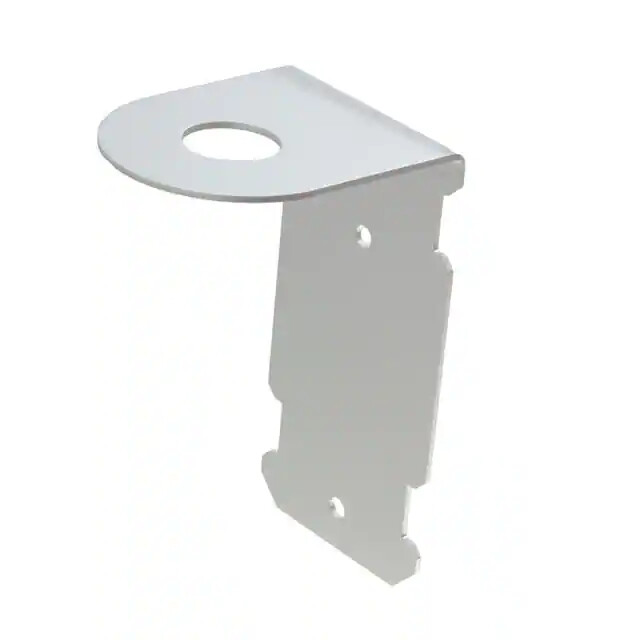

@robvogelsang These will work fine
https://www.amazon.com/Bingfu-Bulkhead-Antenna-Extension-Wireless/dp/B07SYPDYLW/ref=sr_1_4?crid=2GHDLOMSE9QLU&keywords=rp-sma+extension+cable&qid=1678016739&s=electronics&sprefix=%2Celectronics%2C78&sr=1-4
I use these to mount to my rack but they could be adapted to anything
