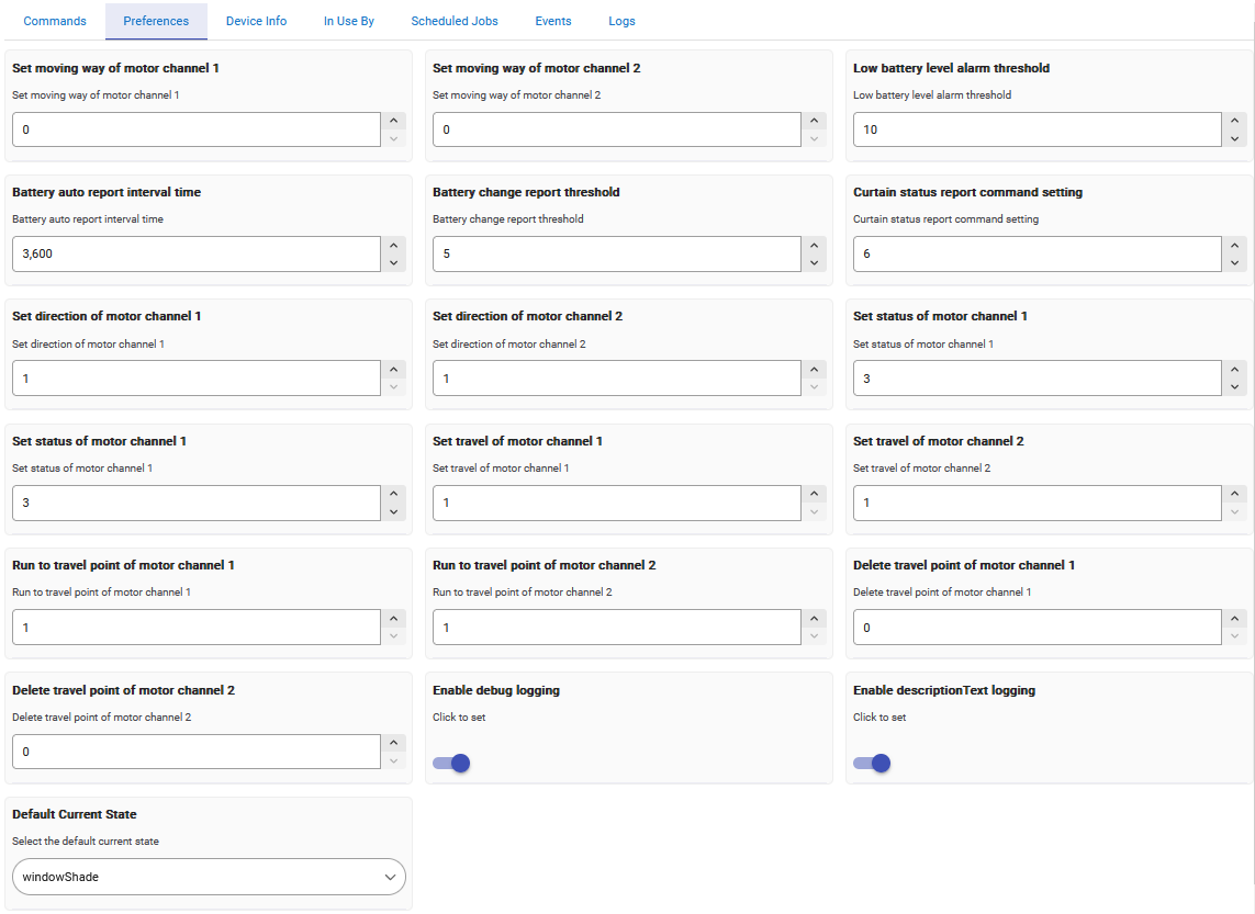

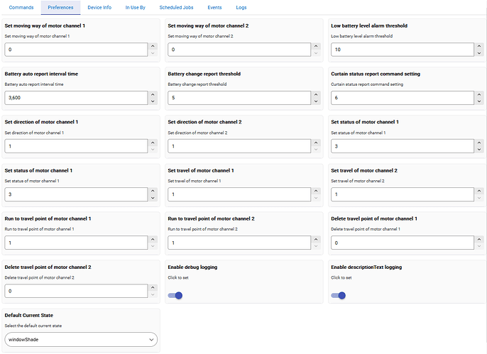

A device using the Generic Z-Wave DT Window Covering has all these juicy-looking properties:

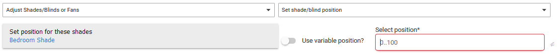

But then Rule Machine's Set shade/blind position can't specify a channel:

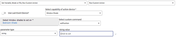

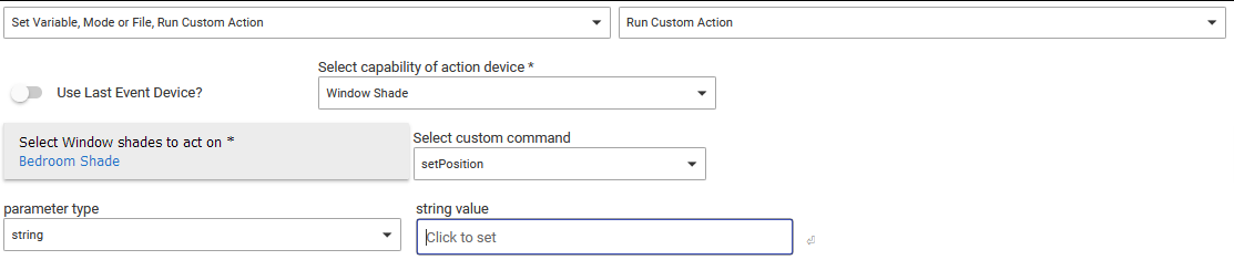

Potentially Run Custom Action → Window Shade's setPosition action could do it--but it's not obvious what the parameters ought to be in order to specify a motor channel:

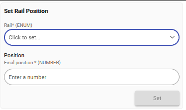

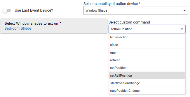

In contrast, the SmartWings Day/Night Cellular Shades device type exposes a really easy setRailPosition custom command to the Window Shade capability:
setRailPosition's parameters correspond to this, in the device's Commands tab (the dropdown list is a choice between top or bottom):

So that built-in driver, is more of a diagnostic/generic driver, the screenshots are actually showing preferences/settings that the device supports. So that is why you couldn't control anything.

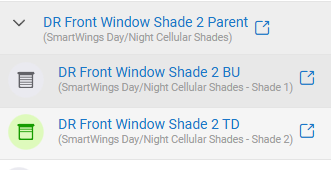

Which device are you interacting with? You should see a parent device and two children devices. If you want to independently control one of the bars, you will need to interact with the child device that controls that bar and not the parent.
I guess I'm interacting with the parent? So the Goggle Home integration can't drive the "Open" which controls both children? When I try to add a Routine to Google Home with the child device (Adjust Home Devices), the Add action is greyed out.
I'm not a google home user, so I don't have any insight into sharing devices to it. On the Hubitat side, your devices should be looking like this. If you have the ability, you'd want to share one of those children to Google Home and not the parent device.
