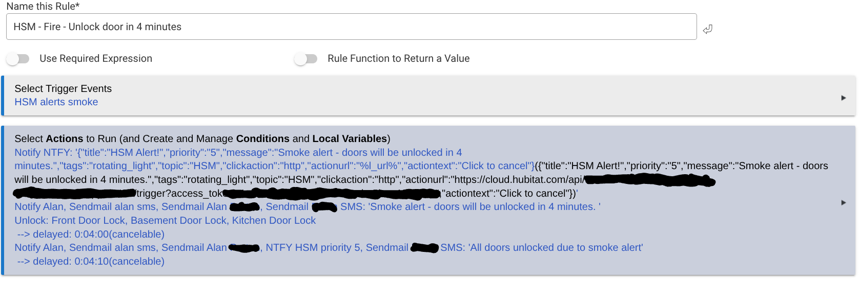

Not a direct answer to your question, but I have some rules to do the same thing, and I'll share them in case you might find them useful. I use two rules, one to unlock the doors after a short delay, and a second one to cancel the unlock action if I choose to cancel it.
Rule 1:
I am using a self-hosted ntfy server with a custom driver. ntfy allows for a 'click action' in a notification, which lets me have a "Click to cancel" that will open a URL. The blacked-out URL is a Hubitat cloud endpoint that triggers the second rule which would cancel this rule's actions. I used a local variable ("%l_url%") in the notification in order to get the URL to come through in a usable format.
I send a notification to multiple devices (SMS, email, Hubitat app, ntfy) just in case I don't get the ntfy alert, but the message text is formatted so the click action will work in ntfy.

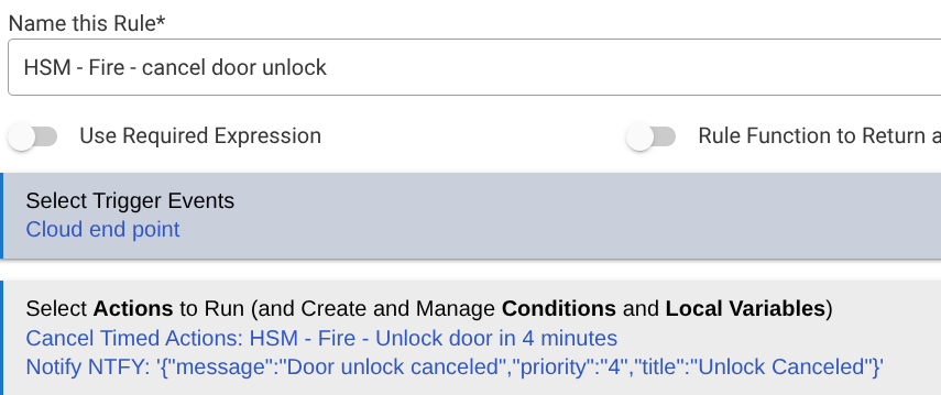

Rule 2:
This rule is triggered by the 'click to cancel' URL in my notification.
