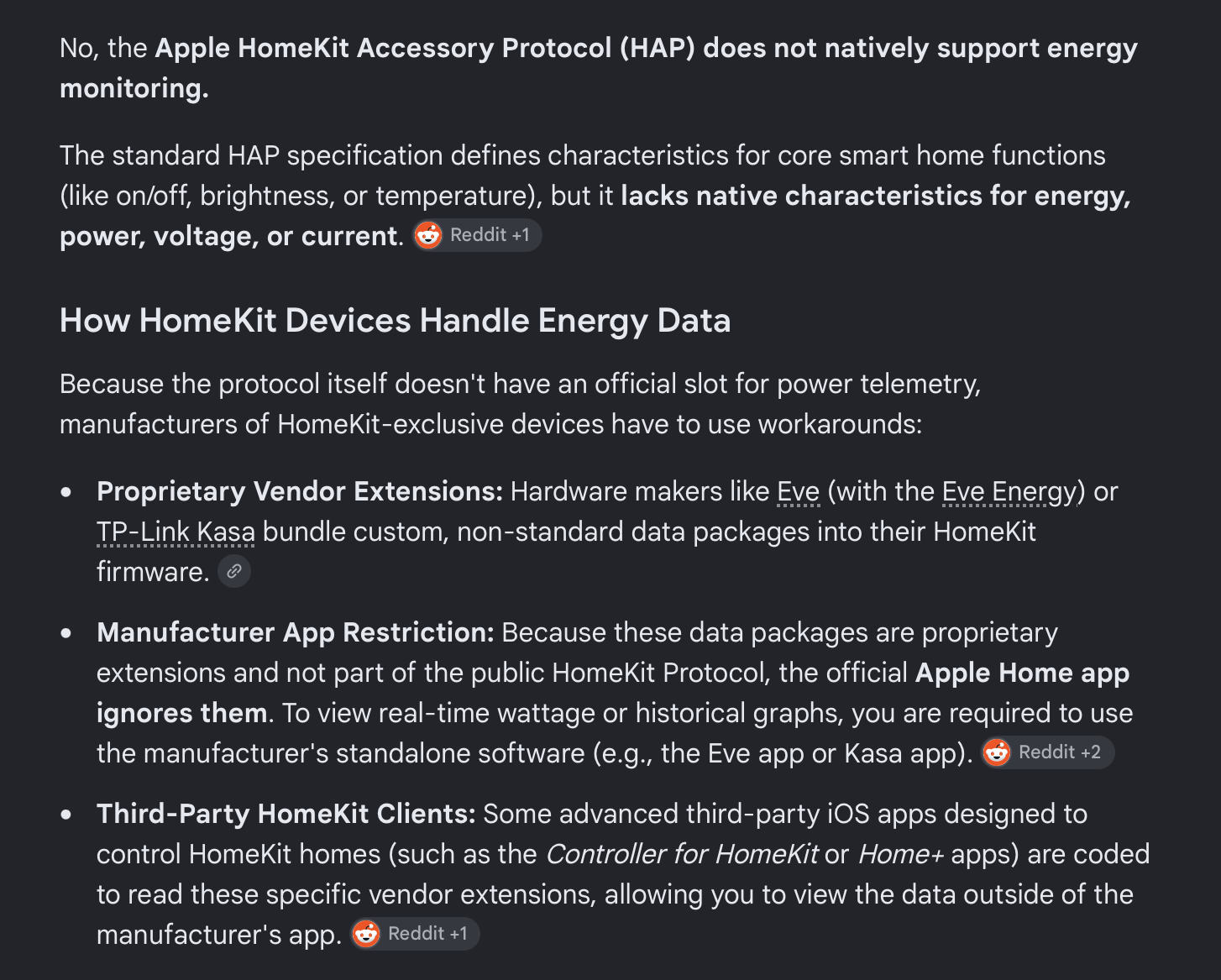

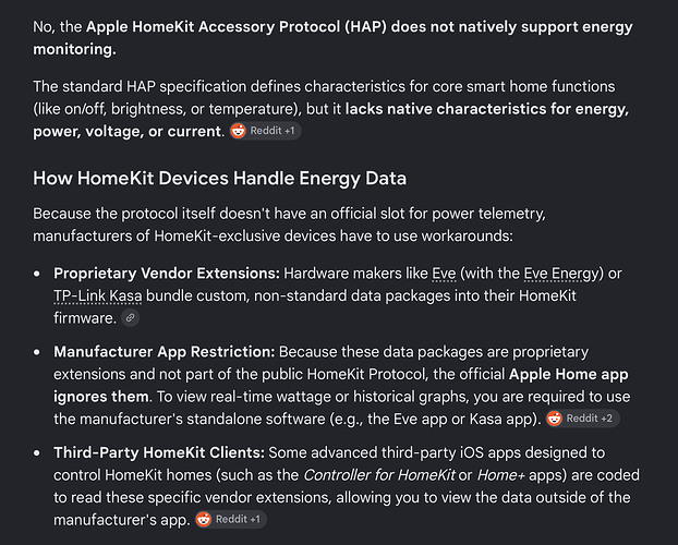

I typically do not like posting AI responses, but in this case Google did a very good job of summarizing the current state of the HomeKit Accessory Protocol (HAP) with respect to energy monitoring devices.
FWIW - AI response below
Thus, I truly doubt that Hubitat will spend any time added support for custom manufacturer-specific HAP data extensions. Apple has moved on to Matter, which now supports energy monitoring.
