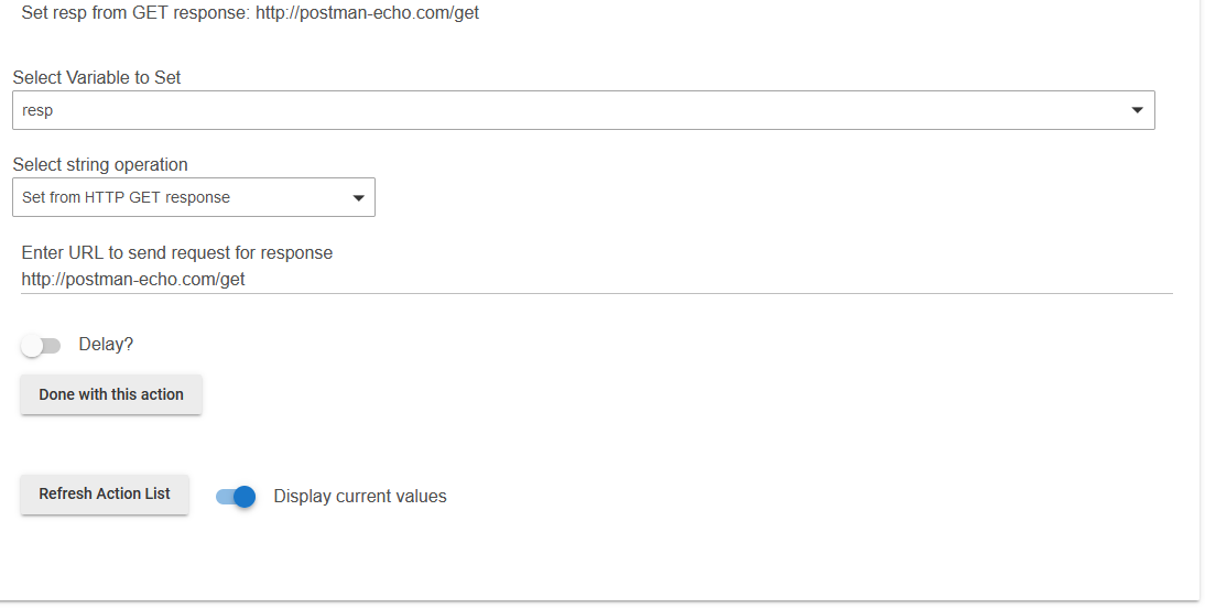

Although, setting is to the response of a GET request to http://postman-echo.com/get results in a null string, not the expected Json reply. Any ideas on what I'm doing wrong?
