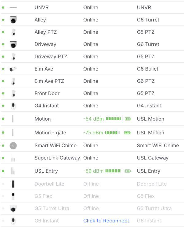

+1 for Unifi. My system has been growing over time so it wasn't an upfront cost. They also integrate nicely with HE. The AI events are so reliable I have replaced my exterior motion sensors with cameras (same cameras, just dual use). I no longer get several false alarms overnight.
I also use HE's Maker API to send the events to a custom Mac app and I can watch the triggers in real time. Response time is fantastic.
I went through two NightOwl systems and Ring before switching to Unifi. Those three systems would have bought a lot of Unifi gear. :wink: The NVR on the first 1080p NightOwl system failed. The second 4k NightOwl lost cameras, but that was probably just the power supply. The Ring cameras were just OK until they let me down when they did not replace a vandalized camera even though they advertise they will. (Not to mention they are now Amazon and have made some sketchy choices.)
Since I was already in the Unifi ecosystem I tried a couple of cameras and haven't looked back. I'm still running some of the Ring cameras only because I like the redundant off-site recording. Now I'm also playing with their SuperLink sensors. The performance has been pretty good so far. Looking forward to see what the smoke/CO2 sensor looks like.
